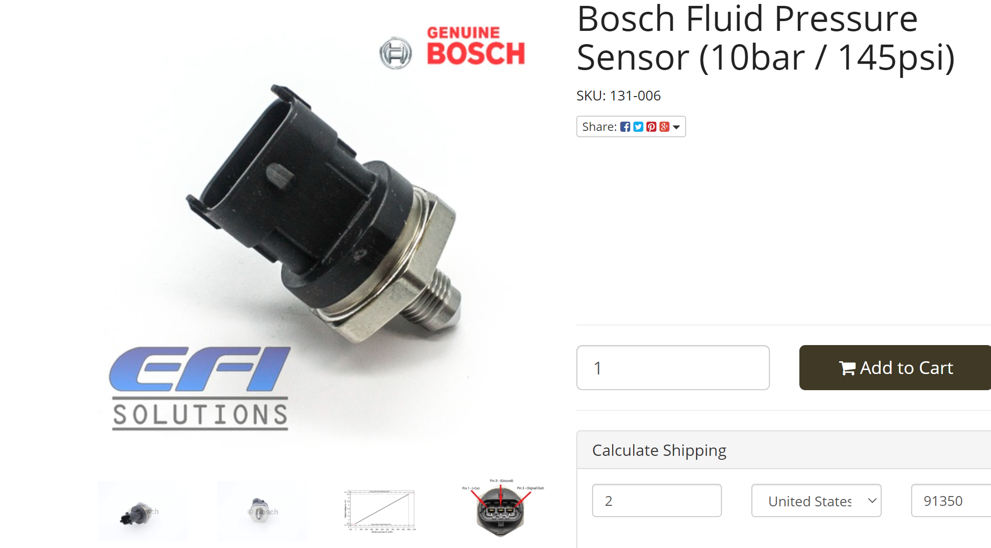

Looks like it should be Bosch pn 0 261 230 365, but there are several variants.

It looks pretty damn affordable at the place you took the screenshot (US$76). I don't have any solid-state pressure sensors that priced that low.
No, it's not that bad of a price. But I'd like to find it domestically and I'm having a hard time doing that. I imagine that if I can find what it came on I can find it for even less.

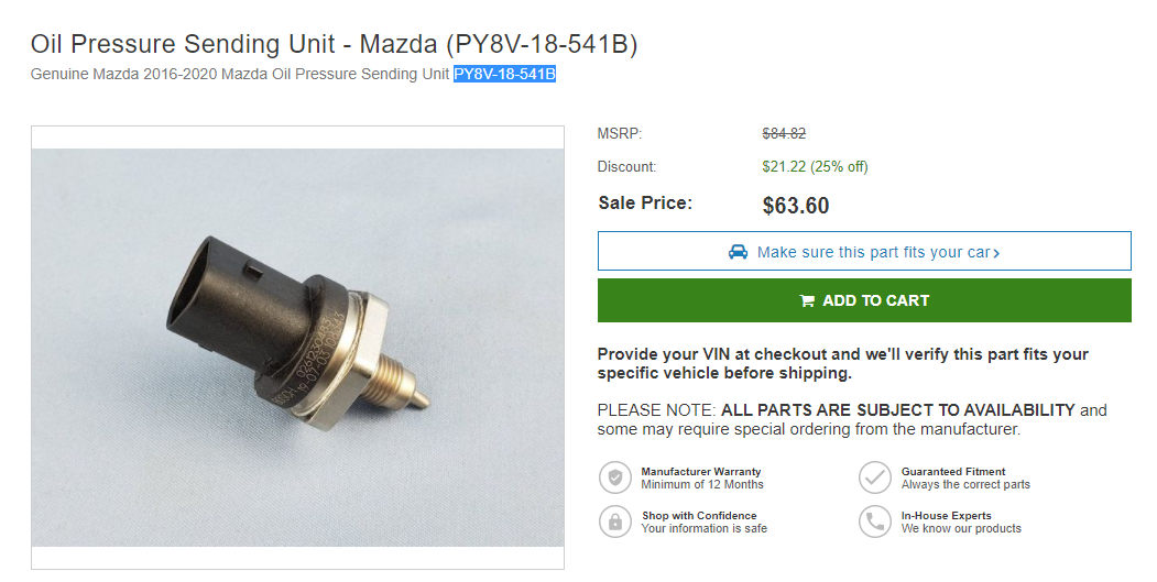

At $99-$109 AUD it's about (or exactly) the same price as the PST-F 1, which for some reason sells in the US for at least $150 US (racecar premiums). But I can get original Bosch sensors for a Mazda for less than half that domestically:
Was hoping to find the same hack for the pressure-only sensor, biggest problem I'm having is figuring out its OE applications. There are lots of Bosch sensors listed as rail pressure sensors for late model VAG cars, so it's easy to discount those as likely being the wrong pressure range. OE parts tend not to offer the transfer functions or specs since it's extraneous information for Joe Blow mechanics trying to get a customer's VW to start and run.

I have seen them fitted on VAG, but they are more expensive than the combined press/temp, so unless you specifically want the odd M10 45deg fitting then you are better sticking with the PST-F1 and just not connecting the temp side.

Did you have a part number for a PST-F 1 OEM equivalent? I looked at both you had screenshots of above but both appear to be pressure only?
