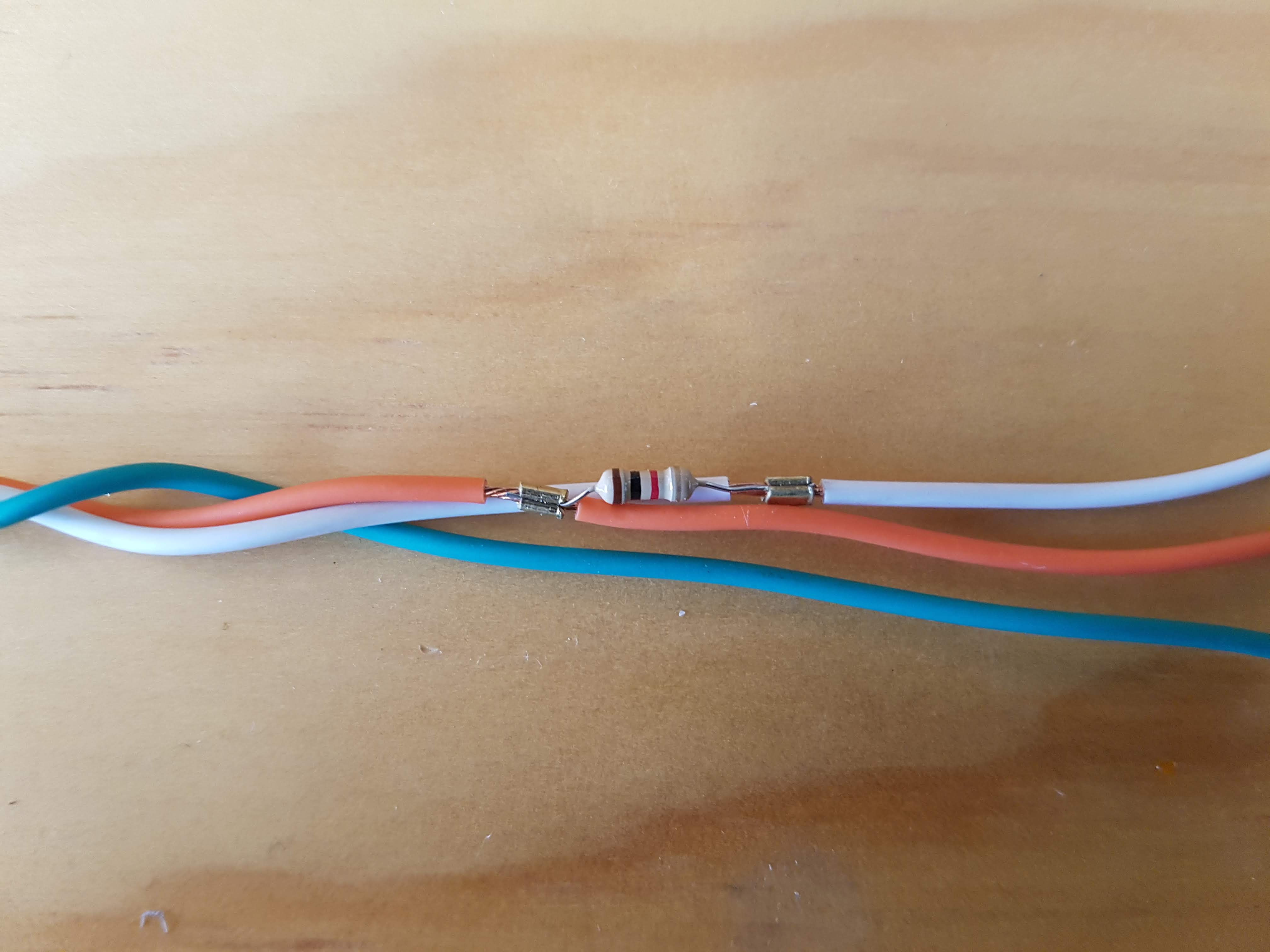

I like to hide them behind connectors, the key is to make sure the entire resistor and its crimp connection is strain relieved and supported in some SCL shrink. For this reason, I don't like to include them in the crimp connection to the connector pin, but instead will remove a section of insulation from the wire that is crimped to the pin, and splice the resistor in here. The resistor body, its splice connections and the two wires to which it is connected them all get sheathed in a piece of SCL to make sure they're rigid, and move as a unit, ensuring the resistor legs won't fracture.
I'm finding it hard to explain clearly... I'll do a wee sample a post a pic, gimme a few.... :-).
I havent shown it, but remember, its crucial that the entire resistor body, legs and crimped sections are strain relieved as one with some rigid SCL, will ensure those resistor legs don't vibrate and fracture :-).

If you can bend one of the resistor legs around you can get them to take up less space, but it gets tricky to make the actual crimp, and need to be careful about the splice staggering and insulation :-).
