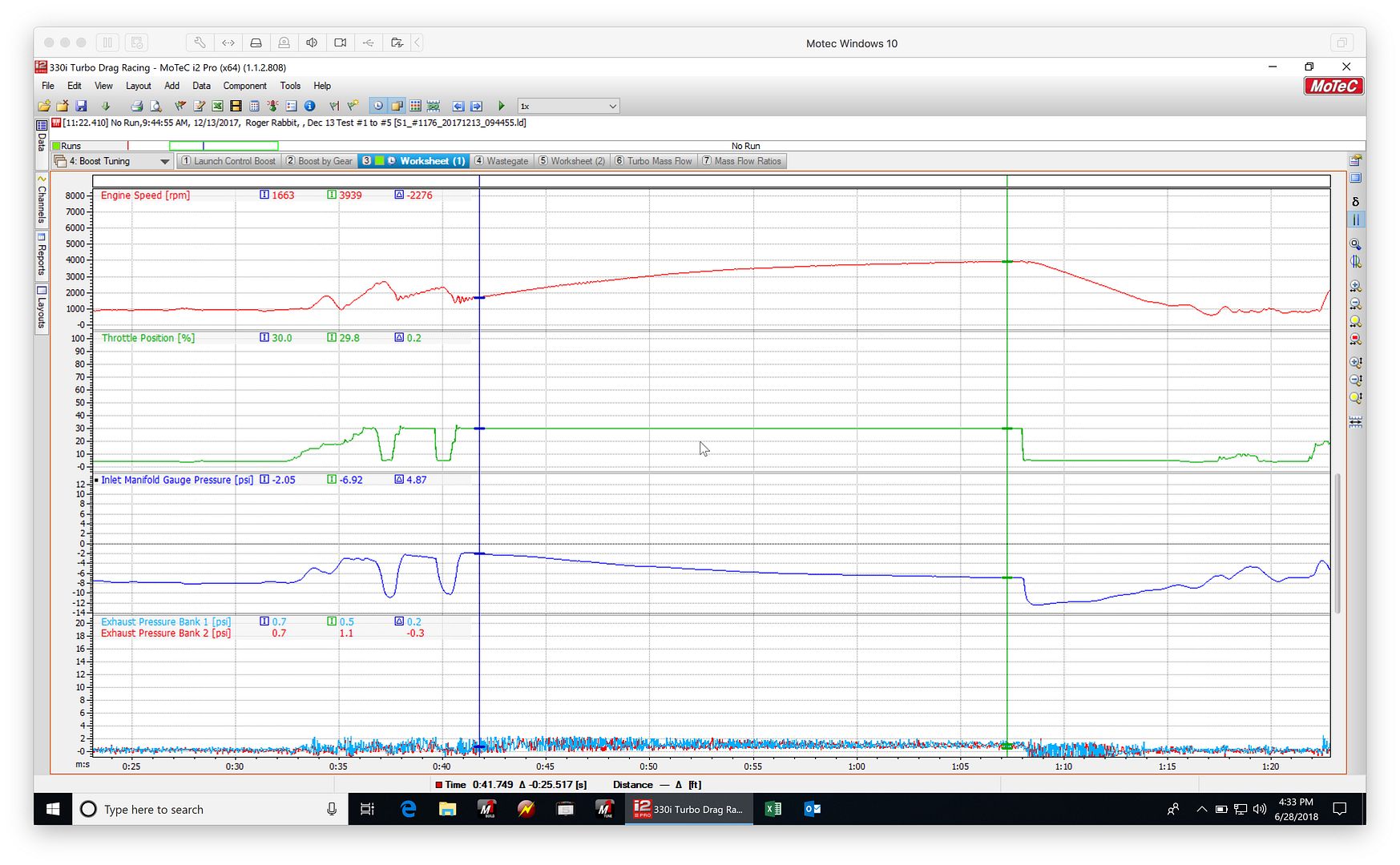

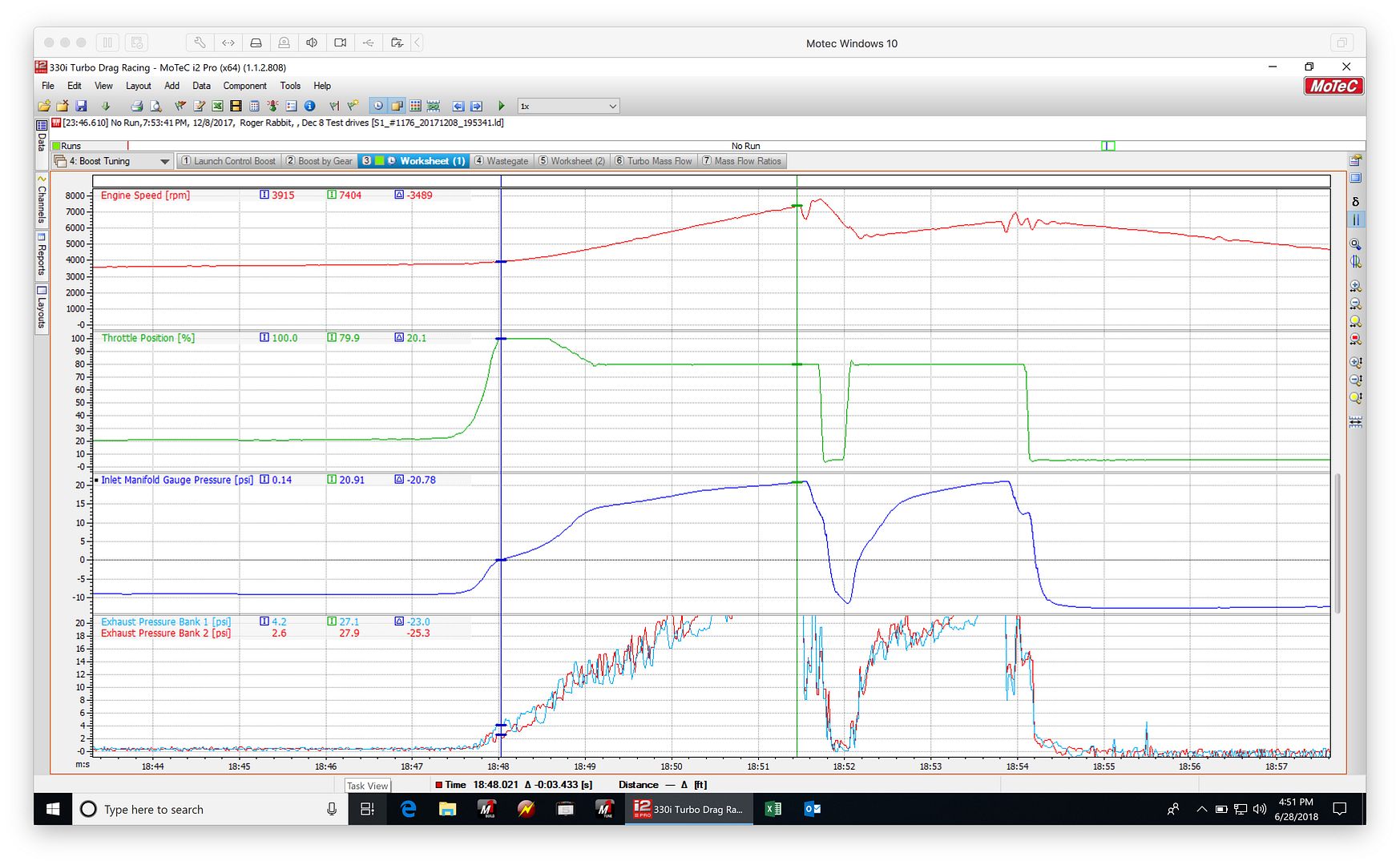

Because I have a Development License for my Motec M1 ECU, this lead me to experiment with Option #7. Using a 10.8 PS WG spring, and EBC turned off, I did controlled testing on a constant grade to evaluate the effects of varying the throttle position. This is what I found from 30% to 70%:

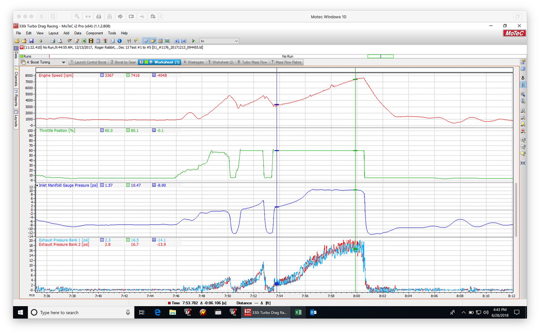

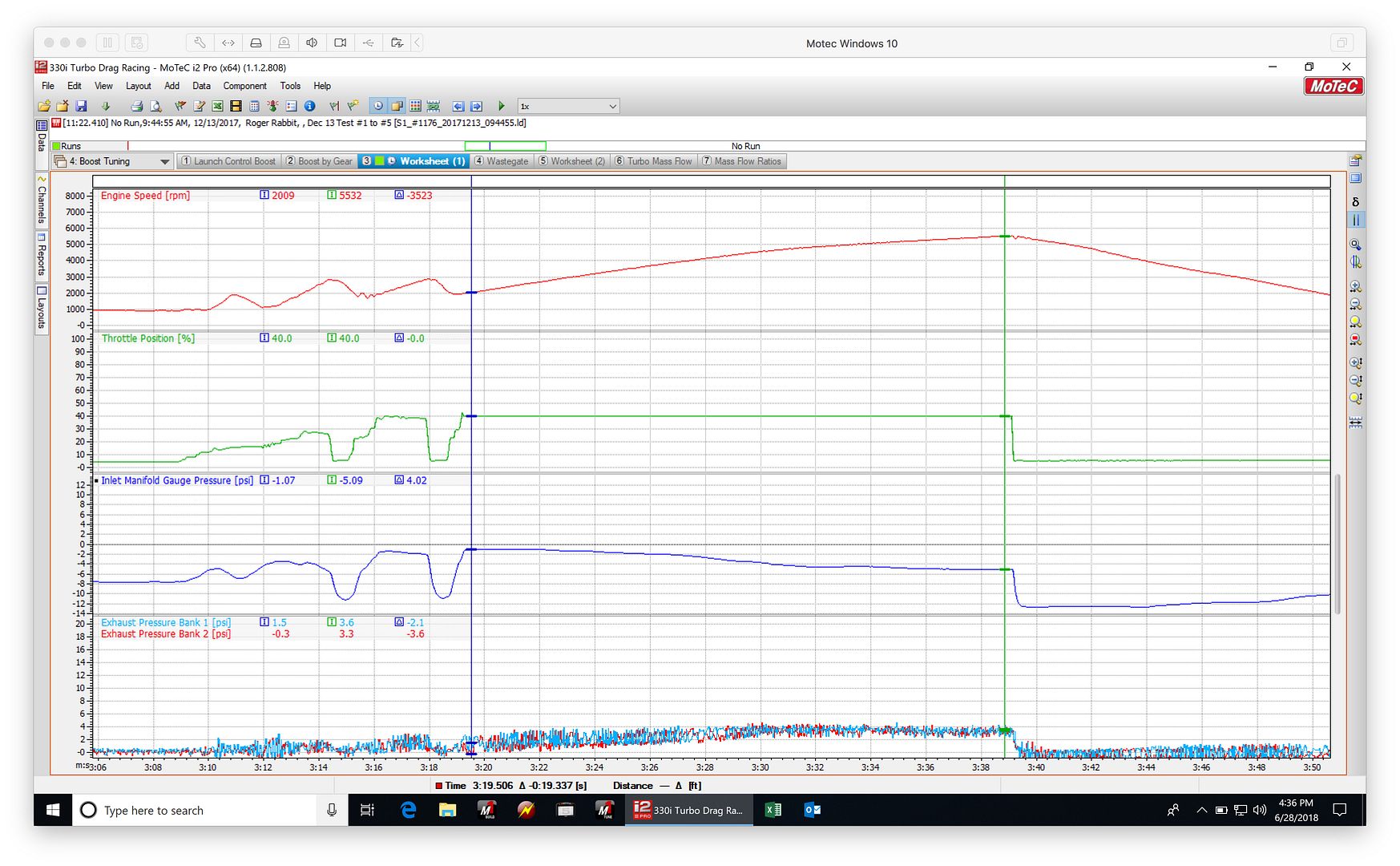

This is a more advanced method test that I did earlier with 80 % throttle:

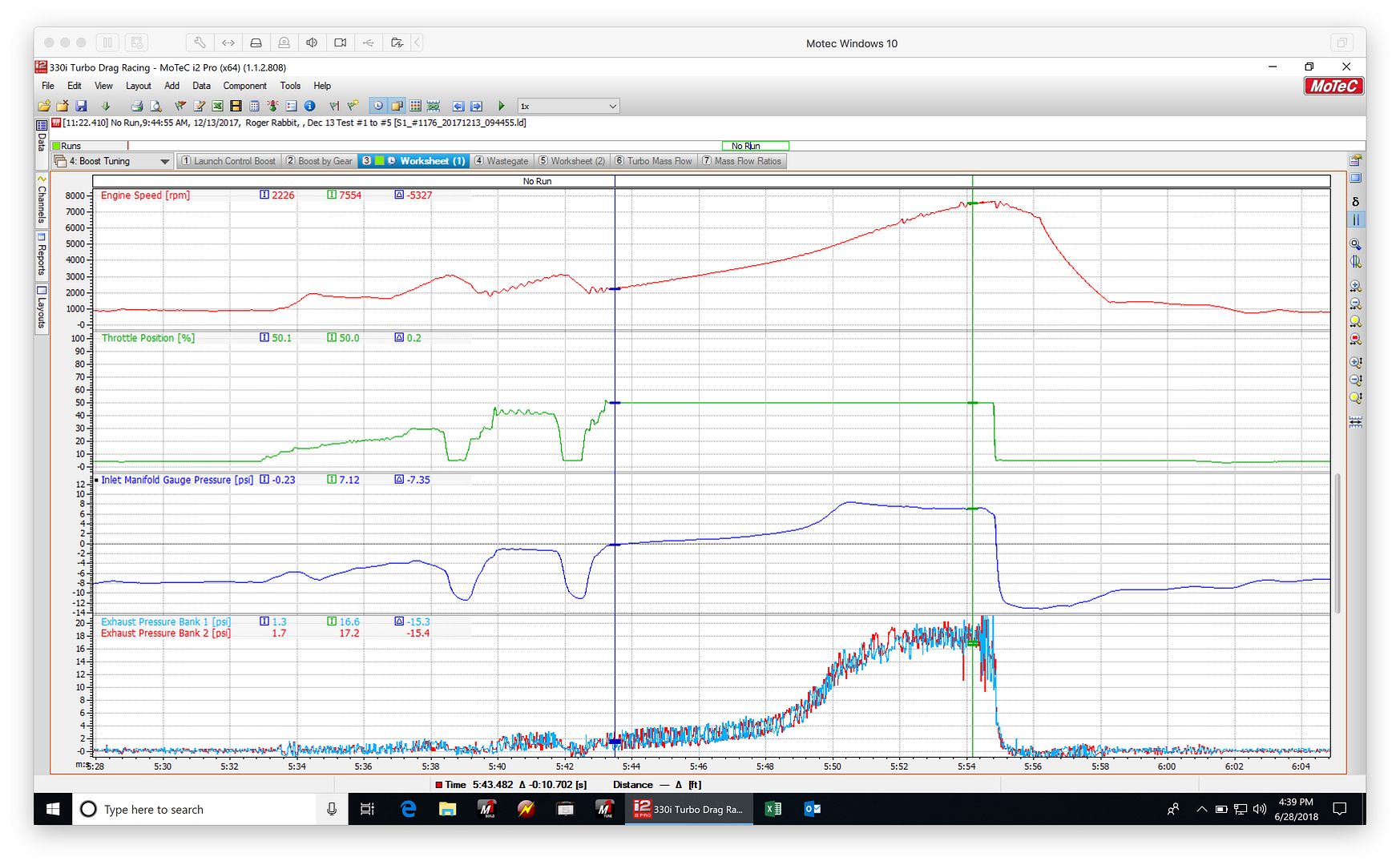

Despite the limited time testing with the GTX4088R, and before I had a chance to investigate any of the waste gate options listed above, I decided I wanted a bigger turbo. I've since bought Forced Performance HTZ GT4205R turbo, and I'm now in the process of fabricating all of the charge pipe work and exhaust again. The question remains: How do I control boost with this highly compromised waste gate situation?

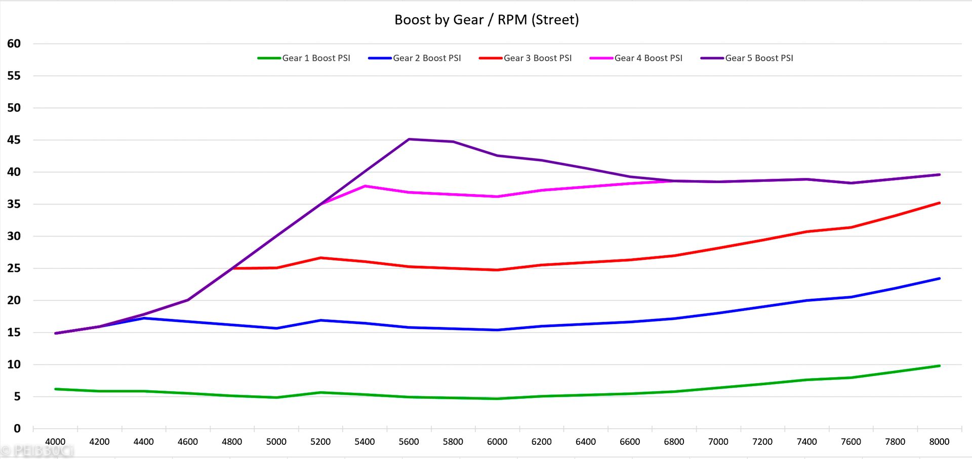

Below are my calculated boost targets for each gear based on known tractive force limits:
Gears 1, and 2 need significant boost regulation, but these are relatively "low" engine loads so I'm not excessively worried about exhaust back pressure. Gears 3, 4, and 5 are higher load where you would not want to generate additional back pressure.

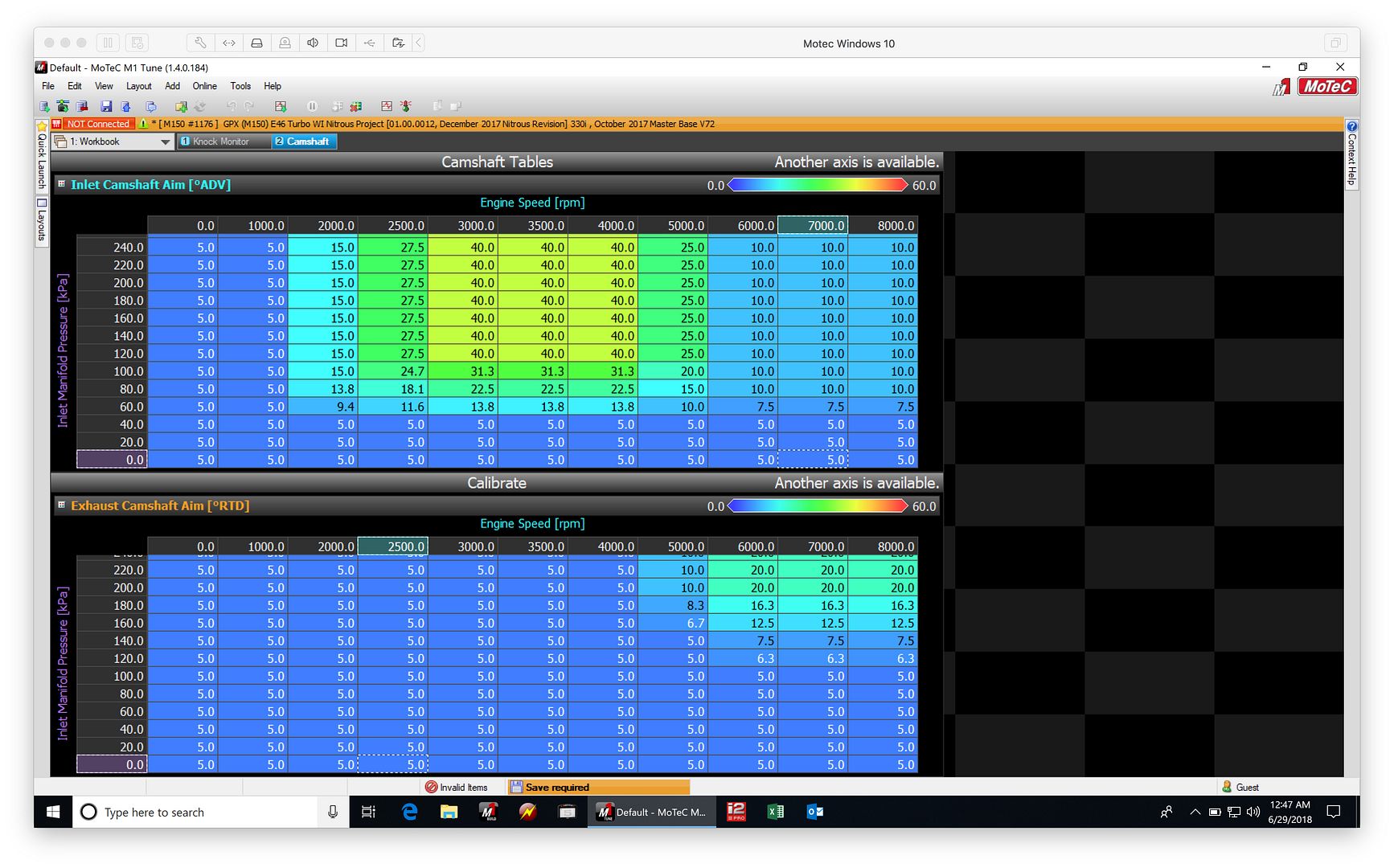

My current VANOS maps:
These are obviously far from being fine tuned. I don't have easy access to either an inertia or load control dyno, so I'm left to do road tuning with lots of data logging. (Currently logging over 700 channels of data at up to 1000hz sample rate)
I'm intrigued to try to use both the camshaft and camshaft phasing to help control manifold pressure. While I'm aware of the effects of overlap, I hadn't actually considered using it as part of the boost control strategy.

See if anyone has reversed engineered the stock maps. Your exhaust VANOS is way off I can tell you, intake needs significant work too.
Bigger intake cams close later and need more intake advance at low end for example.

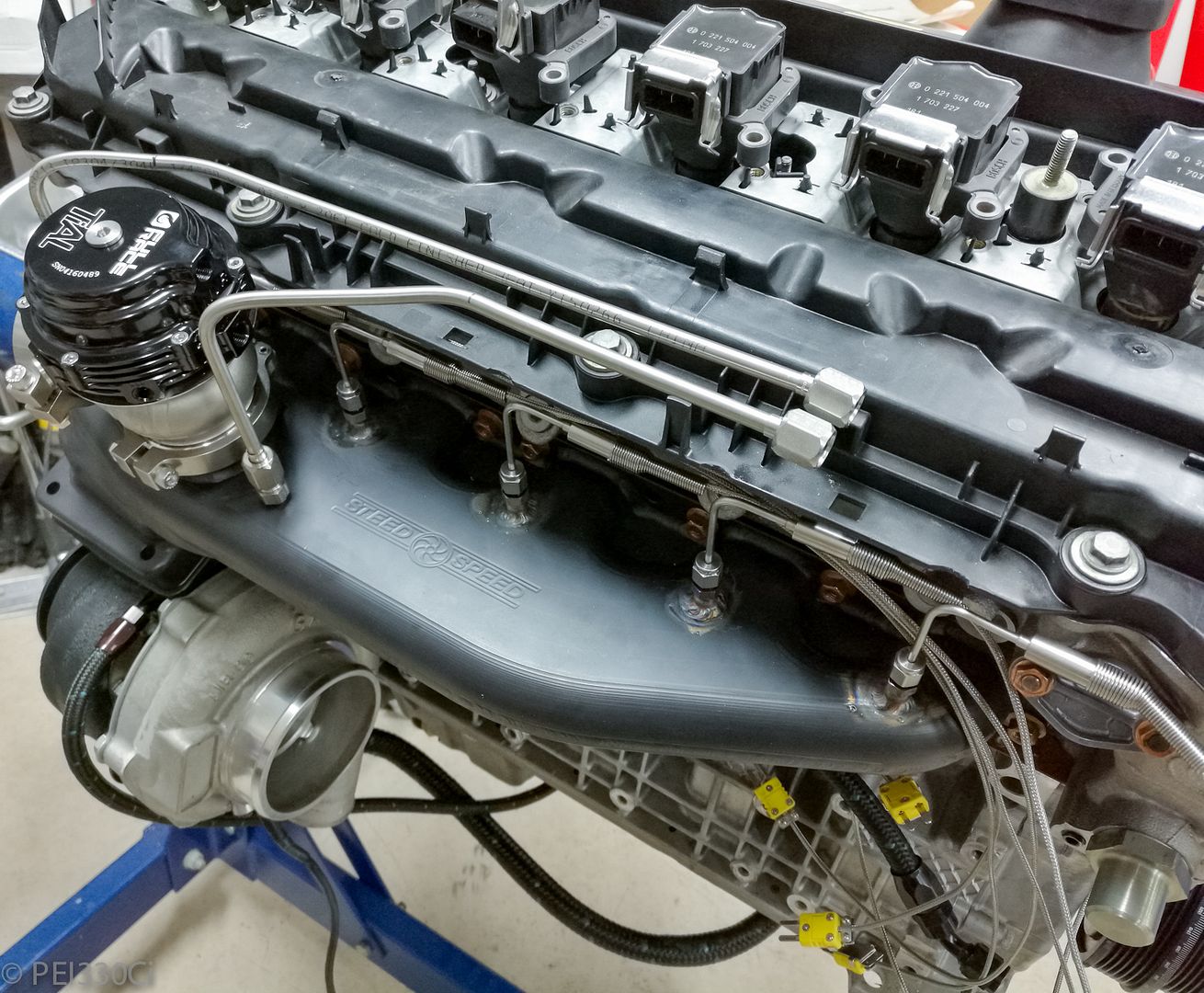

One of my main questions is: Why don't OEMs attach waste gates to the outside radius of the turbine housing scroll?
Borg Warner puts the IWG at the entry to the scroll with the EFR turbos, but they have proven to be highly in-effective at managing boost if you have a very efficient turbo manifold like the one that I'm currently using. (We are seeing boost creep up to 22-23 PSI before stabilizing, making lower boost targets impossible)
Of the 7 options I've listed above, running a waste gate or 2 on the turbine housing is the most recommended by experienced fabricators. Changing the manifold would create more problems than it solves from a packaging and longevity perspective.

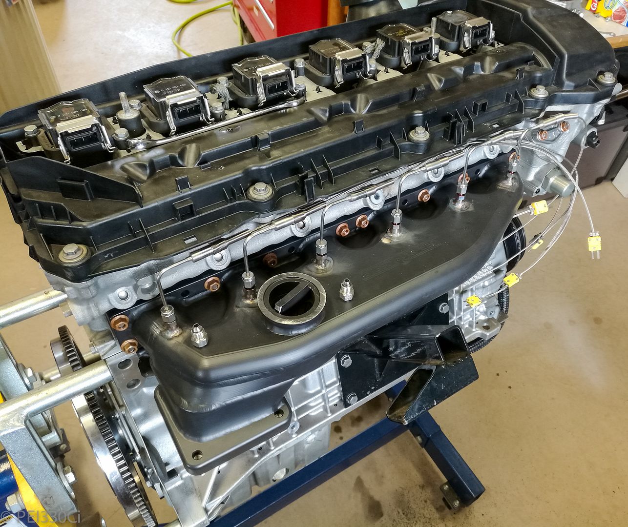

Also, for those that haven't picked it up yet from the photos:
Bank #1, with Cylinders 1-3, has a straight shot at 1/2 of the WG port.
Bank #2, is compromised. Cylinder #4 has a straight shot. Cylinder #5 has to make a 120 degree turn, and Cylinder #6 has no direct path to the WG port. (It merges with the flow from Cylinders 4 & 5 just before the turbine housing)
While I am concerned about the reduction in WG flow that this situation creates, boost control isn't the only variable affected. My issue with this is that you are affecting the VE of each cylinder differently, as you open the Waste gate. So rather than have a fixed VE curve for each cylinder based on manifold pressure, the engine will see less airflow through cylinder #6 than cylinder #1, and this will vary based on the difference between the boost target and manifold pressure.
I don't have individual Lambda sensors on the manifold, but I'm now looking to add them. (At least to do the initial calibration)

If you can post the stock VANOS maps that would still be very helpful. I was aware that this engine wasn't turbo from the factory. I'm familiar with the N54 VANOS maps. I am attaching the stock N54 ones here; the aftermarket is running more aggressive than this. Yes your engine isn't direct injected but directionally you can understand where to go with these maps.
Please note that these maps are in camshaft centerline degrees (absolute), not in relative degrees of advance or retard like your Motec maps. Compare the upper left corner (idle, baseline value) to the right most corner to understand what the relative position is. So the baseline position is about 125 on the intake side, and 132 on the exhaust side. Basically from 1500 they are retarding 30 degrees at WOT on exhaust side and advancing 40 degrees from. I looked up your cams on the Schrick website. It says part #0261 E1 721-DV0 , 272 degree duration, centerlines/baseline position at 126 degrees on intake and 86 on exhaust.

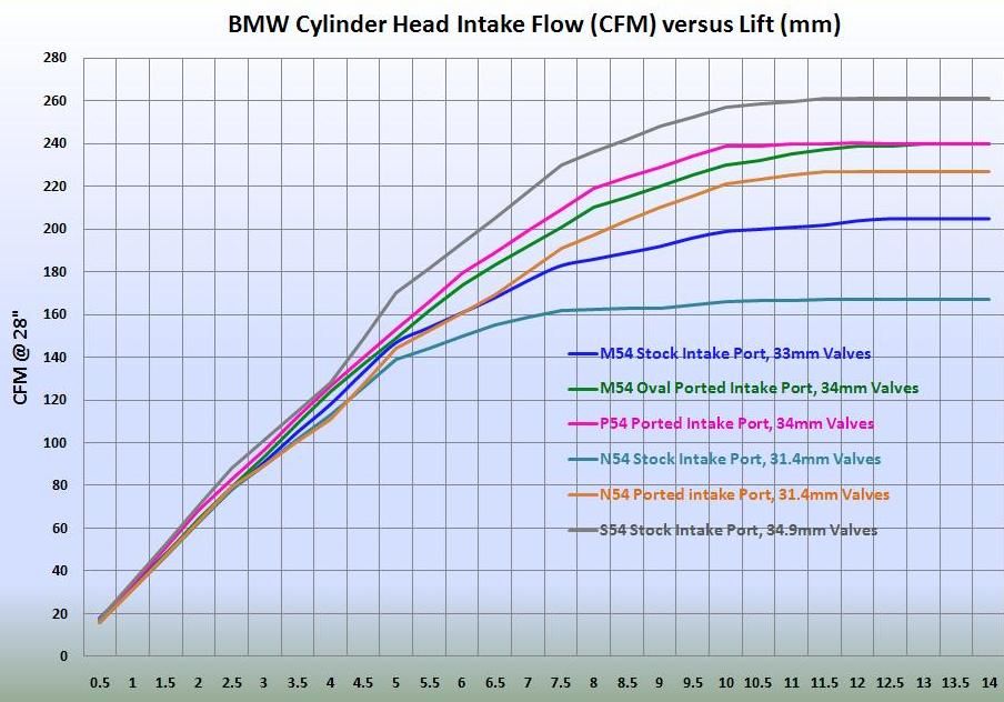

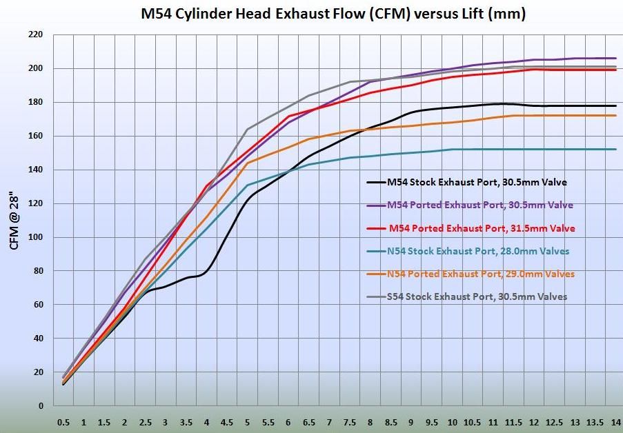

There's something else relevant to the conversation that I would like to share. Below is flow bench data that I have colated; most of it I have paid for to have done for my own projects over the years.
The cylinder head that is currently being used on my engine:
M54 Oval Ported Intake / 33mm Valves
M54 Ported Exhaust / 30.5mm Valves
Those flow results follow the expected trends. Direct injection heads flow poorly compared to port injection, especially port injection heads designed for high revving power. For a cylinder head there is always a tradeoff between tumble coefficient and flow coefficient at a given valve angle.
If you put those heads on a tumble bench you'll see there's much higher tumble on an N54. And in regards to Valvetronic engines, you put an N55 (and equivalent B series engine) or S55 (current M engine, twin turbo Valvetronic) on a swirl bench, you'll see that they have much higher swirl when the valves are doing offset lift mode. The offset lift mode is purely a fuel economy thing during cruising. Valvetronic doesn't give you power directly; it just allows you to use a better flowing head and still get the fuel economy benefit. But enough about Valvetronic, since this is a port injected dual VANOS head.
Getting back to your engine: So the large ports, big intake cam with late intake valve closing timing and big turbo are good for high rpm power. The exhaust cam is counterproductive though because of the way VANOS works. The cam has a later exhaust valve opening timing, which is good for low end due to the increased expansion stroke. It's got a late exhaust valve closing timing, which gives you a big overlap and is good for low end spool and is probably contributing to your boost control issues.

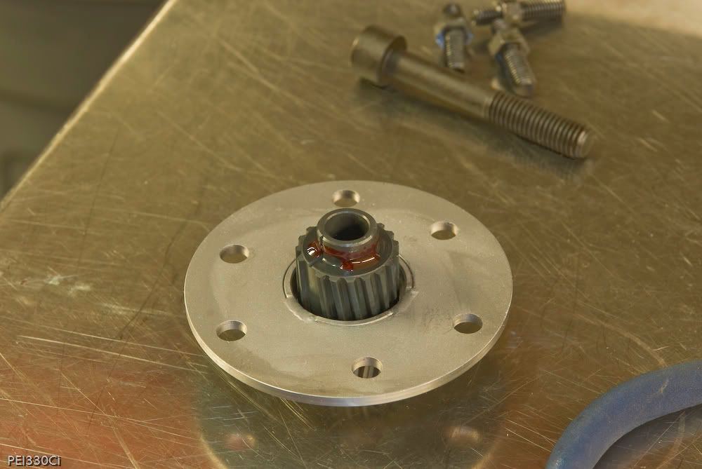

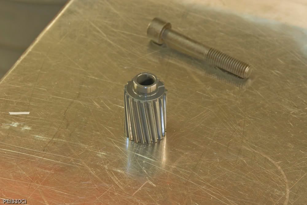

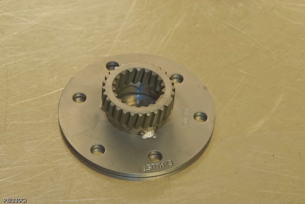

There is good news: I can rotate the splines that are part of the VANOS mechanism.
BMW doesn't sell the VANOS spline or attaching bolt to the camshaft, they only sell the complete cams if you have to replace something. The reason is that the spline doesn't have a locking pin to orient it, it is simply put into a jig on the cam, and then bolted to the camshaft. I had problems previously (As far back as 2009) with cam timing, so I start to investigate this further. What I found was that when the engine rev'd faster than stock, the VANOS put so much torque into the rotation of the camshaft that the spline would move. Then the camshaft would give an error, because in the resting state it was out of position.
This is the spline:
This is the tool to align it on the camshaft:
And here is my solution to keep the spline from rotating on the camshaft:
So the splines on my current cams are loctite'd on, but I can pull them off and rotate them to change the resting camshaft position.

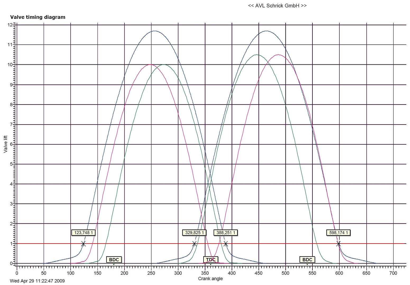

This is part of the previously mentioned cam card from Schrick comparing the 300/296 custom cams, with 264/248 cams:
Any thoughts on putting an MVS waste gate directly on each scroll of the turbine housing?

The 1mm lift reference point shown above is actually a standard reference point for OEM cam design. And the Austrians/Germans like to list their valve events in degrees ATDC firing like you are seeing that diagram.
It looks like the above cam diagrams show your big custom cams for whatever application that was and then the VANOS range for the 264 cams, correct? Same cams at baseline position and then fully phased? Those 264's actually look pretty good for your application. The baseline position has almost 0 overlap, so you can use the VANOS to control spool, just like any other modern turbo engine with intake and exhaust variable valve timing. In contrast those 300's are way too big for boosted + dual VANOS unless it's one trick pony kind of application and all you care about is operating in a very narrow range with highly tuned parts to run there.
Do you have a diagram like this for the 274 cams we've been talking about, the ones on the engine right now? The specs I gave for the N54 engine's stock cams were measured on the engine at 1mm lift.
Also, one wastegate per scroll is a good idea, although you may need a tubular manifold to do it, rather than trying to actually tap into the turbo... It's very common on engines that boost control problems like Rx-7's. The other option is to run one big single gate and pull one big runner off of each scroll, merging into the big single.
OR if you decide you don't care about low end, switch to a monoscroll turbo, maybe even V band inlet. Monoscrolls are better for top end power due to lower backpressure.
Now I think the jury's still out on those 274 cams. I really want to see a cam card like above, or barring that I would like to see the measurements at 1mm lift (IVO, IVC, EVO, EVC) for both baseline position and fully phased.

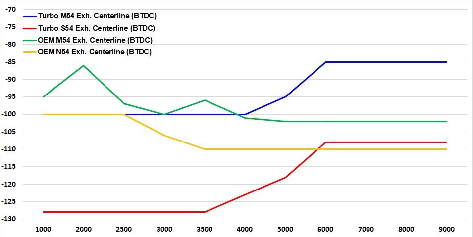

I didn't get the cam card, but I did turn everything into a Cam lobe centreline graph for comparison:
Now I see what you're talking about with the exhaust cam!
My mistake was that I used the map from the turbo S54 straight up, without considering the resting state of the VANOS.
The good news is that I definitely can rotate the helix spline on the exhaust camshaft to move it's resting state to -125 Deg BTDC.
