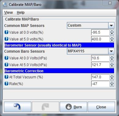

I fired up my TunerStudio using an MS2 Extra example, and I found that the menu Tools->Calibrate Map/Baro... window gives you the chance to set this up,
Using the info in your picture, I would try setting a custom map sensor with Value at 0 volts (%) as -96.5, and Value at 5 volts (%) as 400.
Here is a picture of what that window looks like for me:

Do I enter all this numbers in the picture?
I only entered the common map sensor numbers you mention
after start up as I rev the motor the cursor only moves to the right it does not move up the kpa chart
No, just the ones in the MAP sensor area. You should upload your project (you might have to put it in a "compressed folder" - zip file) for uploading. Then we can take a look.
