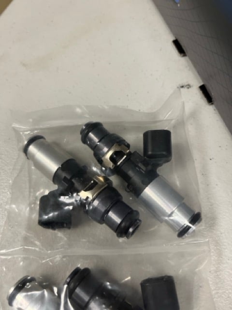

You don't have the correct combinations of upper & lower adapters for the Duratec/MZR. Here is a picture of mine (installed, showing a shorter purple top, and silver bottom adapter):
Installed Injector
Here is a picture of new ones showing what will work with the Duratec/MZR The box identifies these as 1050.60.14.14B.4
New Injectors
  • Solo los miembros Gold pueden descargar archivos adjuntos. Obtén más información sobre cómo convertirte en miembro Gold aquí.

The adapters slip on/off easily. I would check with your source for the ID injectors to see if the parts are available separately, or if you can swap what you have for what you need, (I don't believe there should be any cost difference).
