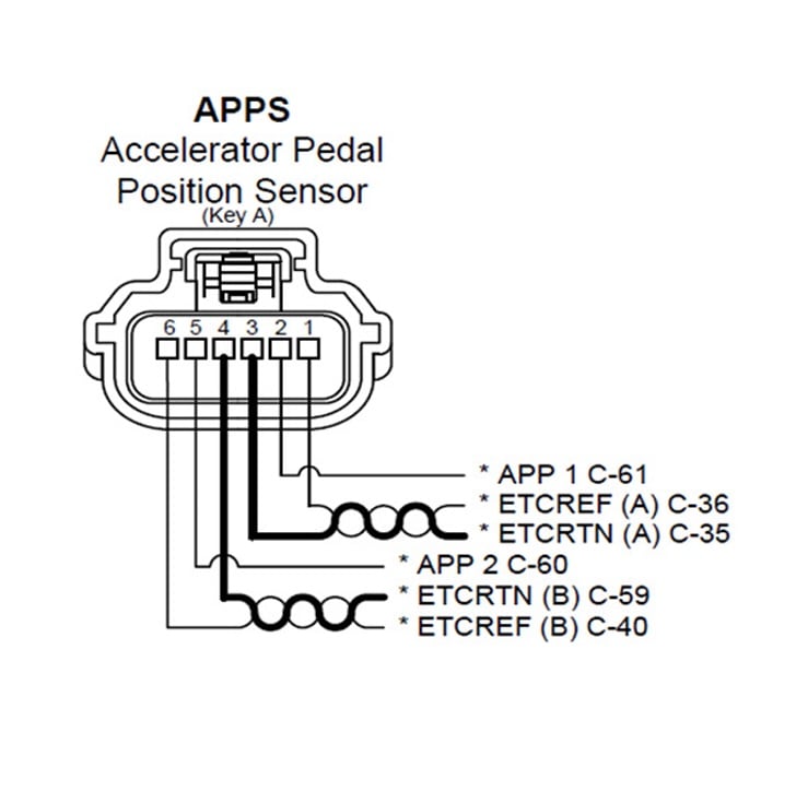

Here is the pinout for one Ford pedal (used in the 2012+ Mustangs)
Mustang Throttle Pedal Wiring
  • Solo los miembros Gold pueden descargar archivos adjuntos. Obtén más información sobre cómo convertirte en miembro Gold aquí.

I saw this. But I can't understand what is ETCREF and ETCRTN.
Aer they +5V and ground?
And Is mustang pedal is BV61-9F836-BB?
ETCRef would be the Electronic Throttle Control reference voltage (+5V), and ETCRet would be the reference return (ground).
The mustang part number is CR3Z-9F836-C according to the Coyote Controls Pack Manual (where I got the pinout from). I would not be afraid to try wiring your pedal like that to see if it works.
Good Luck!
Most of the ford focus pedals from around that era only have 1 analog signal (APP1), the APP2 output is a PWM signal that EMU wont be able to use. The last one I wired had the same pinout as David shows, so you will likely only need 5V to pin 1, Gnd to pin 3, Analog to pin 2.
Thank you.
When I measure the resistance and voltage with a tester, they change, so I'm thinking they're probably both normal analog signals, but is that not the case?
It worked when I disabled Pos.inv., but I don't think that's necessarily correct, so I decided to buy a different throttle body. I'd like to try that as well.
