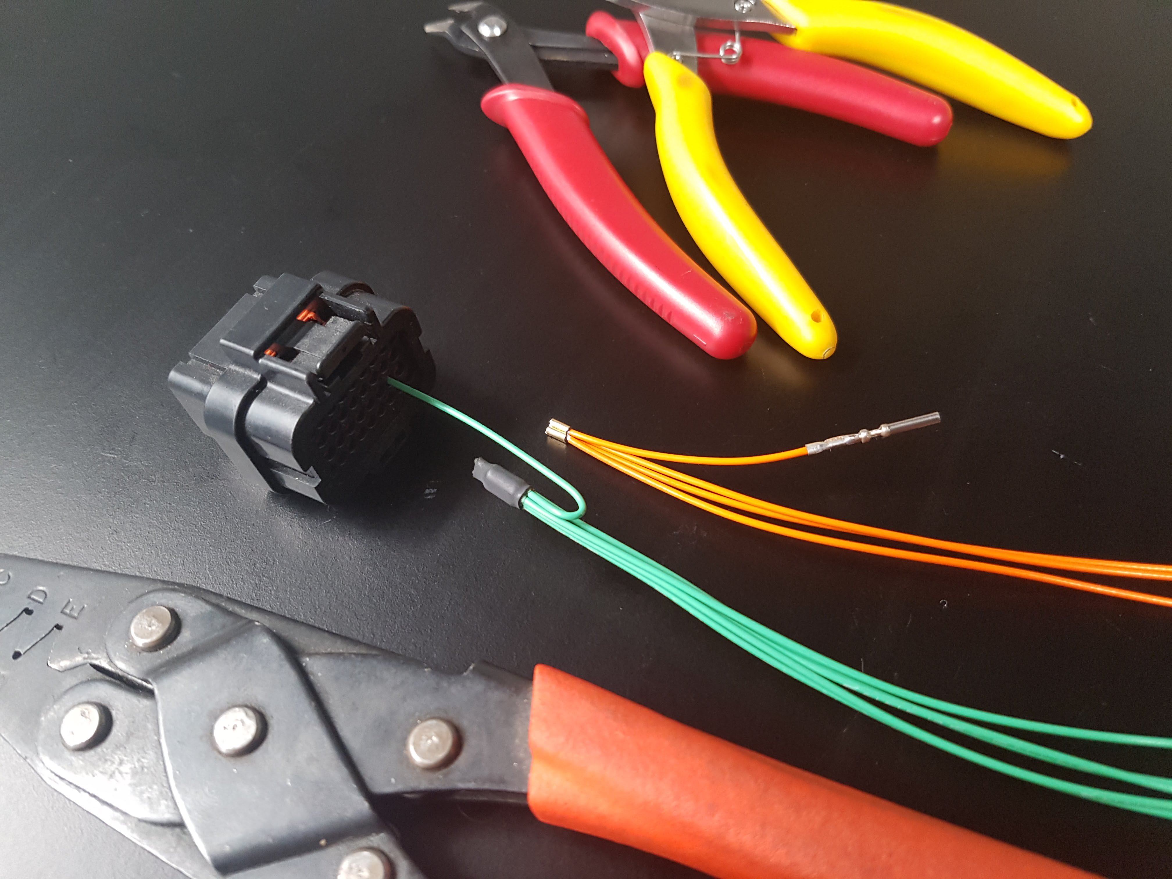

To answer your question though, I usually splice out a single 5V supply wire right behind the ECU connector to the number I need. This picture should give you an idea of what I mean:

Zac, thanks for the picture, very neat way to do the splice.
