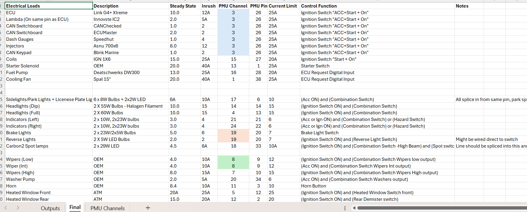

Hello
Hoping someone could take a look at my planned output sharing and confirm that there will be no issues.
Need to share outputs in order to have enough channels.
So, currently I have channel 3 spliced out to quite a lot, but no major power draws.
ECU + Lamda power - Both share the same pin at the ECU side from previous setup, so left it like this
x2 CAN Switchboards
Dash Gauges power
Injectors
CAN Keypad power
Other shared outputs
Channel 19 Brake and reverse lights, since they both have their own switches and are both LED so very low amp
Channel 17 - Sidelights, park lights, license plate lights, power to gauge lighting and switched power to glovebox light
Thats it, I couldn't see any more than can be shared without loosing control options.
Any issues with any of this?
From other threads it seems fairly common to combine ECU and Injectors, but seems best to leave coils by themselves, I added the other outputs in because they are all very low amperage, and the SB's need to function with the ECU anyway, since they control all inputs to the PMU.
