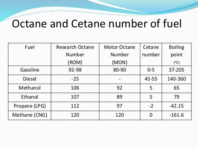

However, it also has a very high 'octane number' and works well in very high compression and forced induction engines - it's sometimes used as a fuel alternative for diesel engines, with the associated spark ignition conversion.
I assume you're looking at your local Autogas - this may also have butane, or other gases, in it, so the effective octane may be lower http://image.slidesharecdn.com/rips-140824115441-phpapp01/95/fuels-octane-number-cetane-number-5-638.jpg?cb=1408881618 - but there should be a federal mandated minimum.
