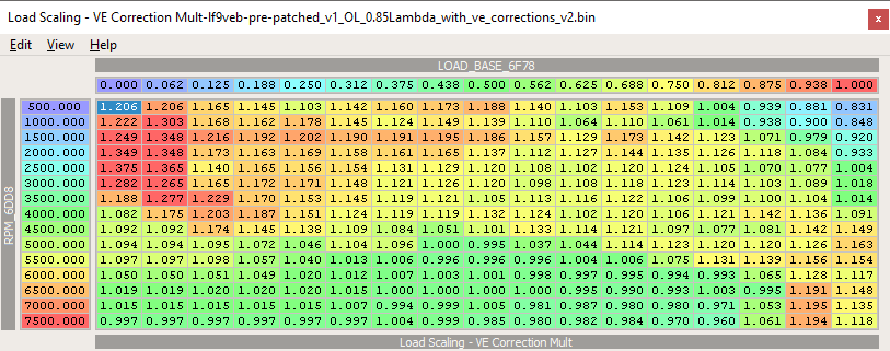

Note: This point deserve a bit of explaining as it might be platform specific, eg: an 2.0L N/A 2009 NC MX5. We have a table that's called "Load scaling - VE corrections" and basically it is to correct the difference between Air mass calculated from MAF/RPM vs. the real Air mass inside the cylinder hence VE. Make sens ? So by correcting that table I get all my trims very closed to 0.
Load scaling/comp
In this specific case, would it make more sens to address the issue in the load scaling table described above ? Somehow it would make sens to change this table if the engine VE is somewhat changed, eg: new headers, perphap cams, etc.
