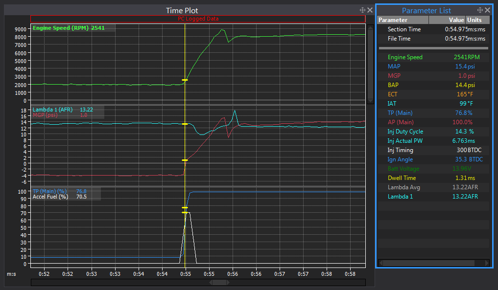

I actually watched your accel enrichment video the other day. What you are saying is I actually have to adjust the transient cells that get hit during the split second a throttle stab happens?
I'm not sure how accurate the data is during this short period of time. I believe my LC-2 logs lambda at 20Hz and in PCLink I have logging at 40Hz. Looking at the log, RPM goes from idle ~1800 to close to 9k in just under 1 second. It shows 1psi of boost at 2.5k RPM which it can't be since the chargers on these skis start making boost at 6k where the log shows already 7psi.

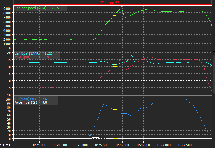

Attached is a screen shot, I'm pretty sure accel enrichment is set too high. Adjusting the wild transient cells in these short throttle blips will be tricky.
I spent some time with a tablet on the water adjusting accel enrichment, it seems these Rotax 1.5L don't need much if any at all. I pretty much turned it off, down to 2% clamp and that got the rich spike from mid 9s to mid 11s AFR.
Takes off great, now just to keep off the RPM limiter which it instantly hits.
