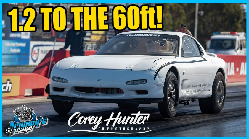

Ive owned my RX7 since 2008 or there abouts. It went to the circuit a few times, then sat in the shed for about 10 years before i revived it during covid to hit the drag strip instead. I am the sole fabricator, engine builder, tuner, wire dude and driver for the car. Which is good and bad, because when it has an issue i cant complain and point fingers at anyone except for myself! I have recently bitten the bullet and attempted to strip weight out of the car with removing the power windows, inner door skin, side window glass and will look to do the same to the rear hatch as well shortly. I race with small 28x9 tyres, and all the other like for like cars to compare it against with the same tyres are generally around 2100lbs. I tip the scales now around 2450lb, so have to make a good 250hp+ more than those guys to run the same et (which is super hard when you are limited by your tyre size)
So far it has made 767rwhp on a mainline hub dyno, and run 8.71 @ 161 mph with a 1.48 60ft on 35psi. It is still a relatively new build, and only done a handful of passes under power. We have been chasing a significant misfire issue of late when boost was pushed past 40, and are headed back to the dyno shortly with new ignition leads and a 16V battery change, as well as a few other odds and ends to hopefully find the cure. The car has also gone a 1.27 60 with plenty more left in it. Looking to get back out on track soon with whatever it takes in the intake manifold to run a 7 (i have no problems pushing the boost gauge into the 50's).
The car runs no intercooler, so will also be trialing turning the nitrous on during the run to see what horsepower effects come from it due to the ability to cool the intake charge (bottle already in the car for transbrake boost building, so no weight disadvantage to using it)
