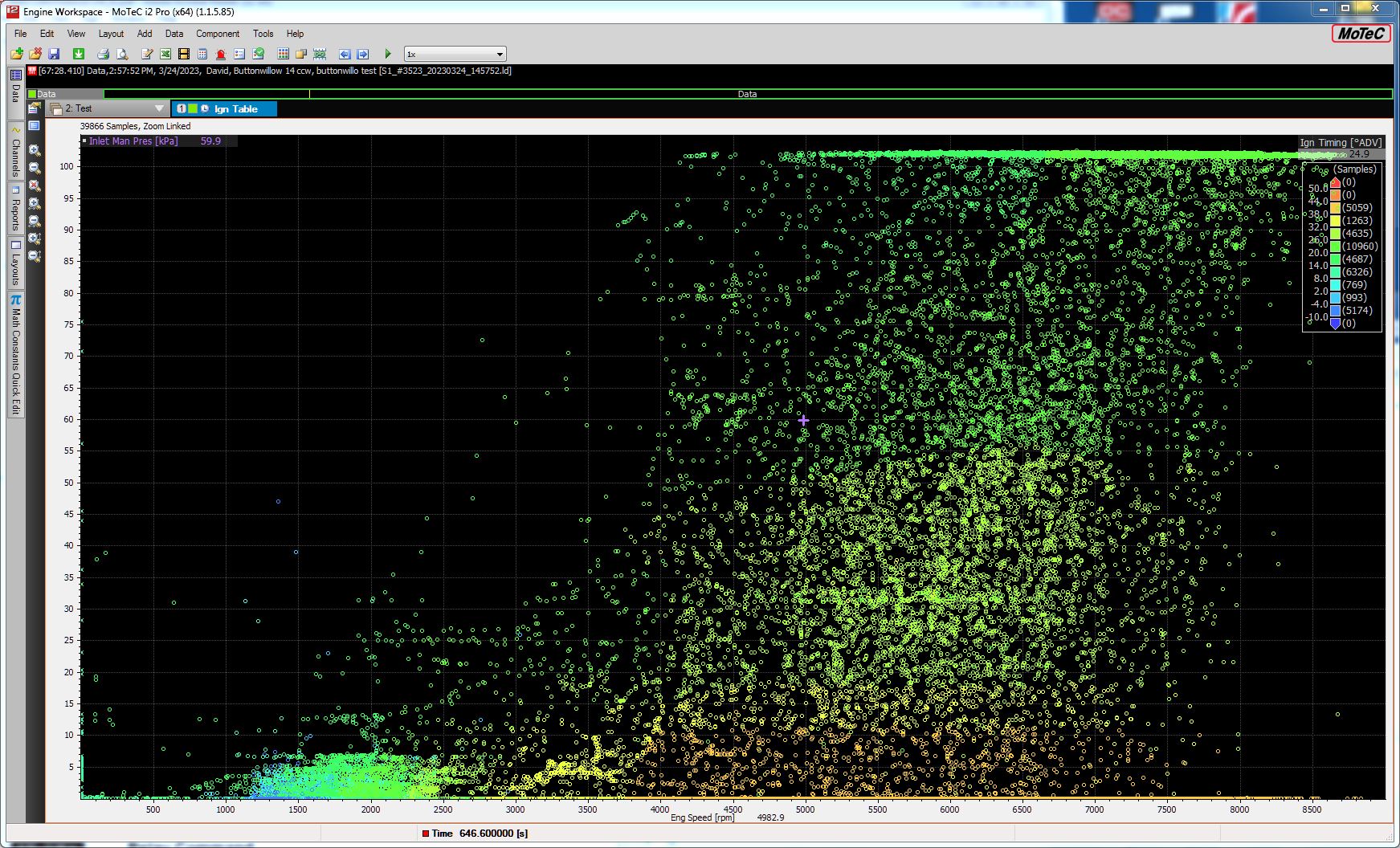

There is no "table" display, a Scatter Plot is the best you can do. With a large enough data set, you can put the cursor near the intersections of the cell values you want to fill out, and capture that value. Here is an example, so the cursor is at 5000 RPM, 60 kPa, and the Ignition Timing is 24.9 deg.
