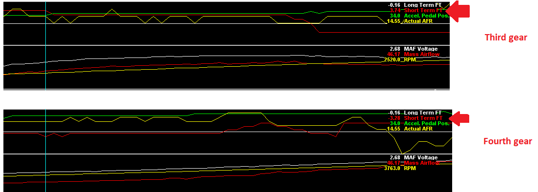

1. I seem to be chasing my tail trying to set the MAF calibration, I have 2 consecutive RPM sweeps showing different trims. 1 sweep may show -3% and the next +3 at the same MAF V position. The variables that are changing are RPM, gear and engine load - Should these influence fuel trims?

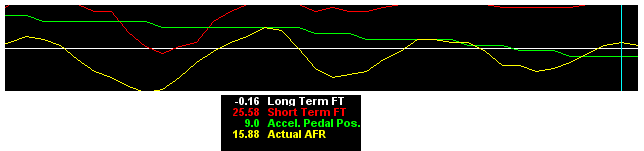

2. When under low load cruising (throttle pretty much closed), It seems like the car is reporting between rich/lean condition, and the system is responding appropriately by pulling or adding fuel, up to the 25% limit. See the yellow line(AFR), in the following picture. The system will swing between 13-17AFR. This is felt in the cabin (unsteady due to extreme lean/rich miss).

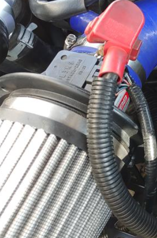

From my research, I believe this has to do with the MAF sensor placement on the intake:

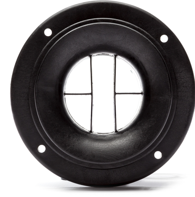

With an air straightener that I normally don't see:
I want to believe that COBB is a reputable company and they know what they are selling, but this design with the MAF sensor right at the filter goes against what I know and research. It is enough to function, but could it be the reason behind what I am seeing?
Thoughts?? Opinions??
Hello im with you on this one i would be adding some pipe to the air cleaner area too prove a point
regards Ross
