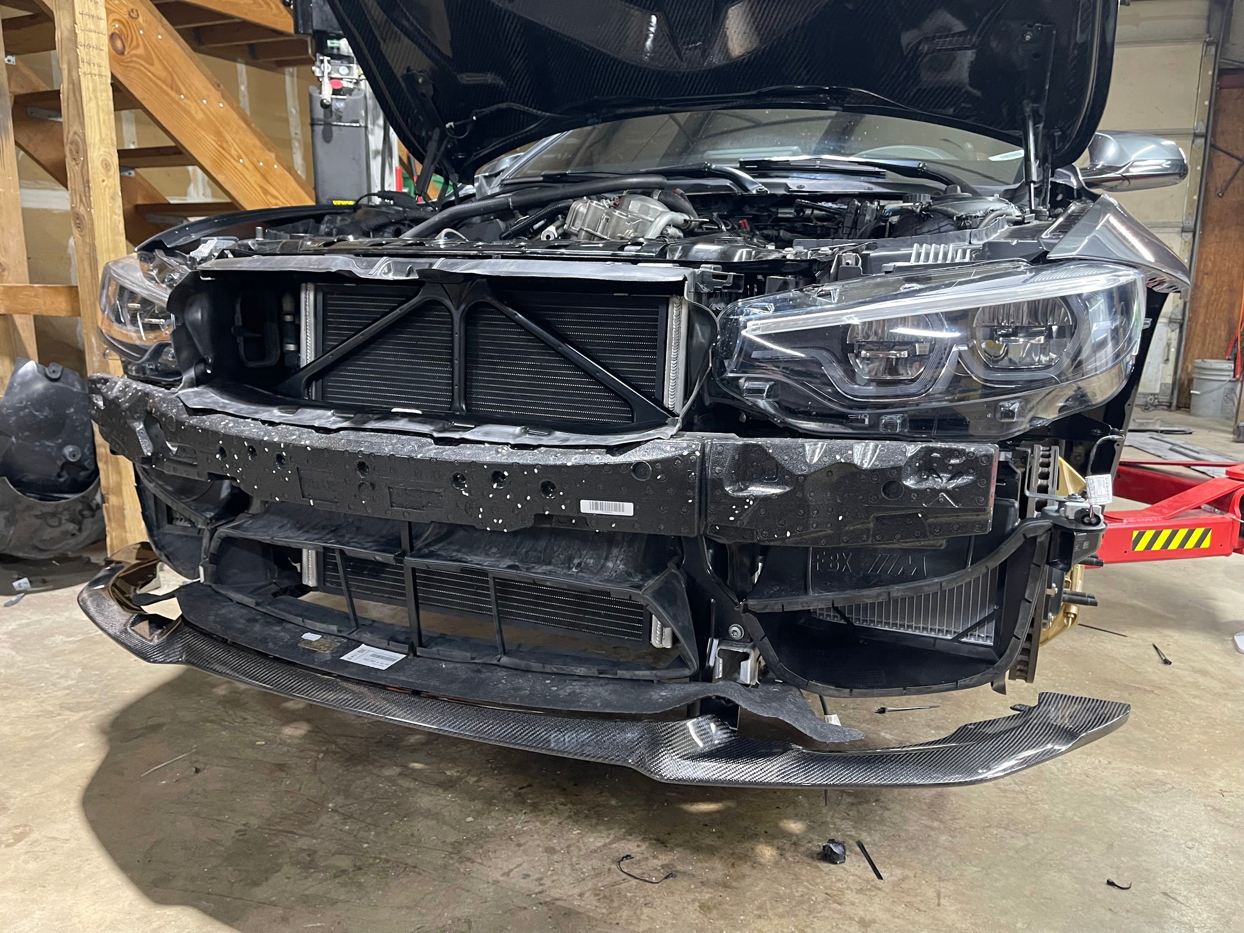

My previous lip: (I bought the car with this original carbon fiber lip). This lip broke.

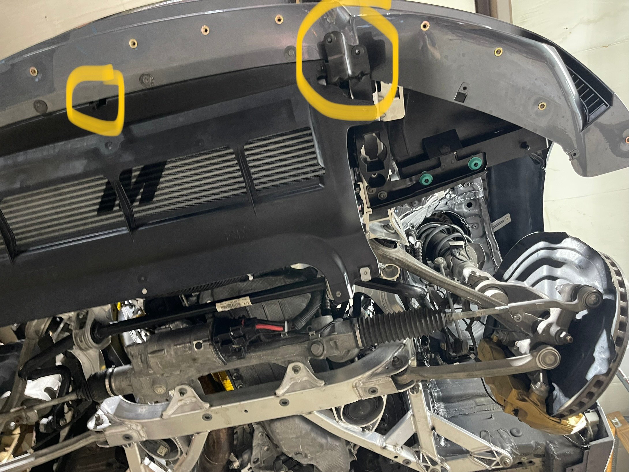

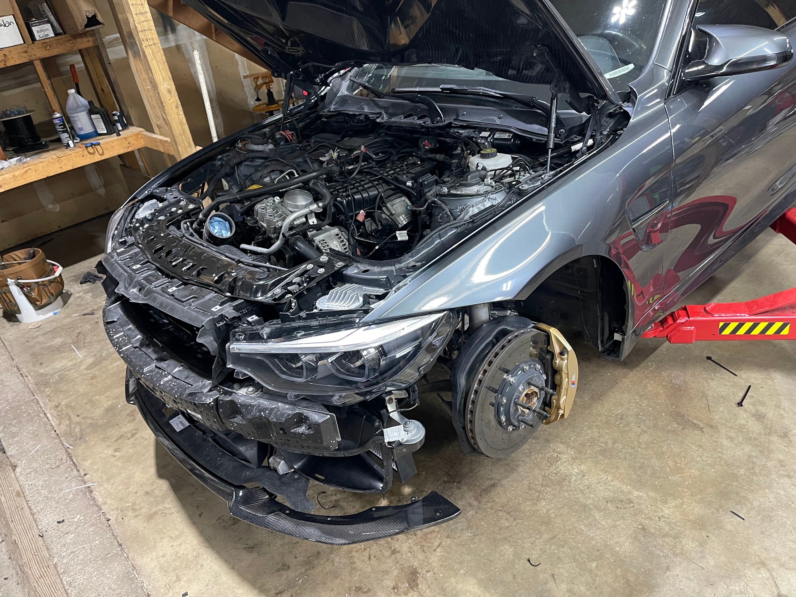

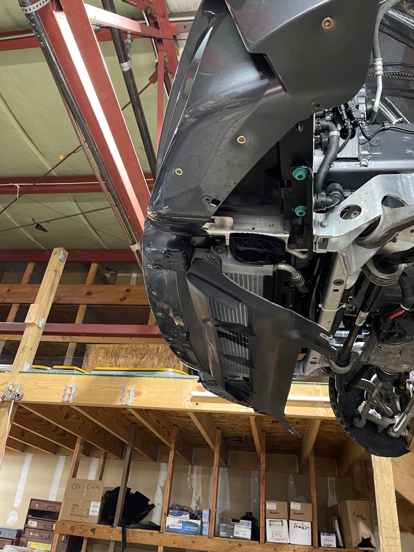

My question: How should I mount this lip. I am thinking about using 2 or 3 screws (with nuts) on the left side and 2 or 3 screws (with nuts) on the right side of the lip in addition to the screws that come from the box. I'll also use doublesided tape but I suspect that will do very little to secure the lip. Do you guys think this is a legitimate way to mount it/have some tips? I do plan on driving this car at high speeds (250kmph) and I would hate for the lip to fall off.
Best option is to run the factory CS or GTS lip Or a good rep that has the mounting points for the oem BMW mounting brackets installed and then also use rivnuts installed into the bumper to greatly increase its strength.
Also filling the lip with expanding foam will greatly increase its strength. They sell 2 part mixable expanding foams meant for boats in varying densities that are very well suited to this use.
