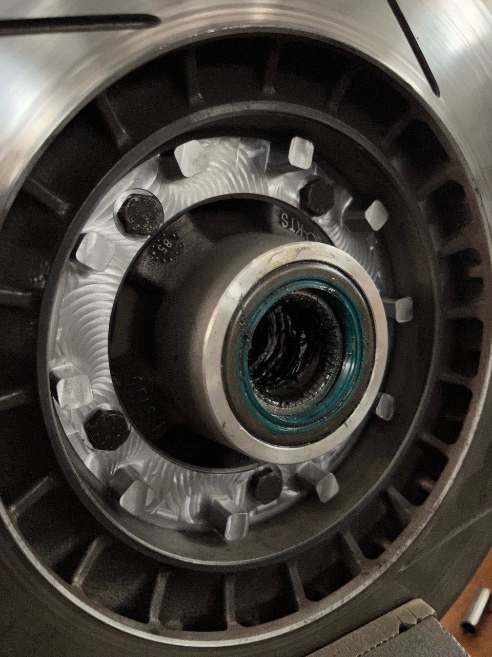

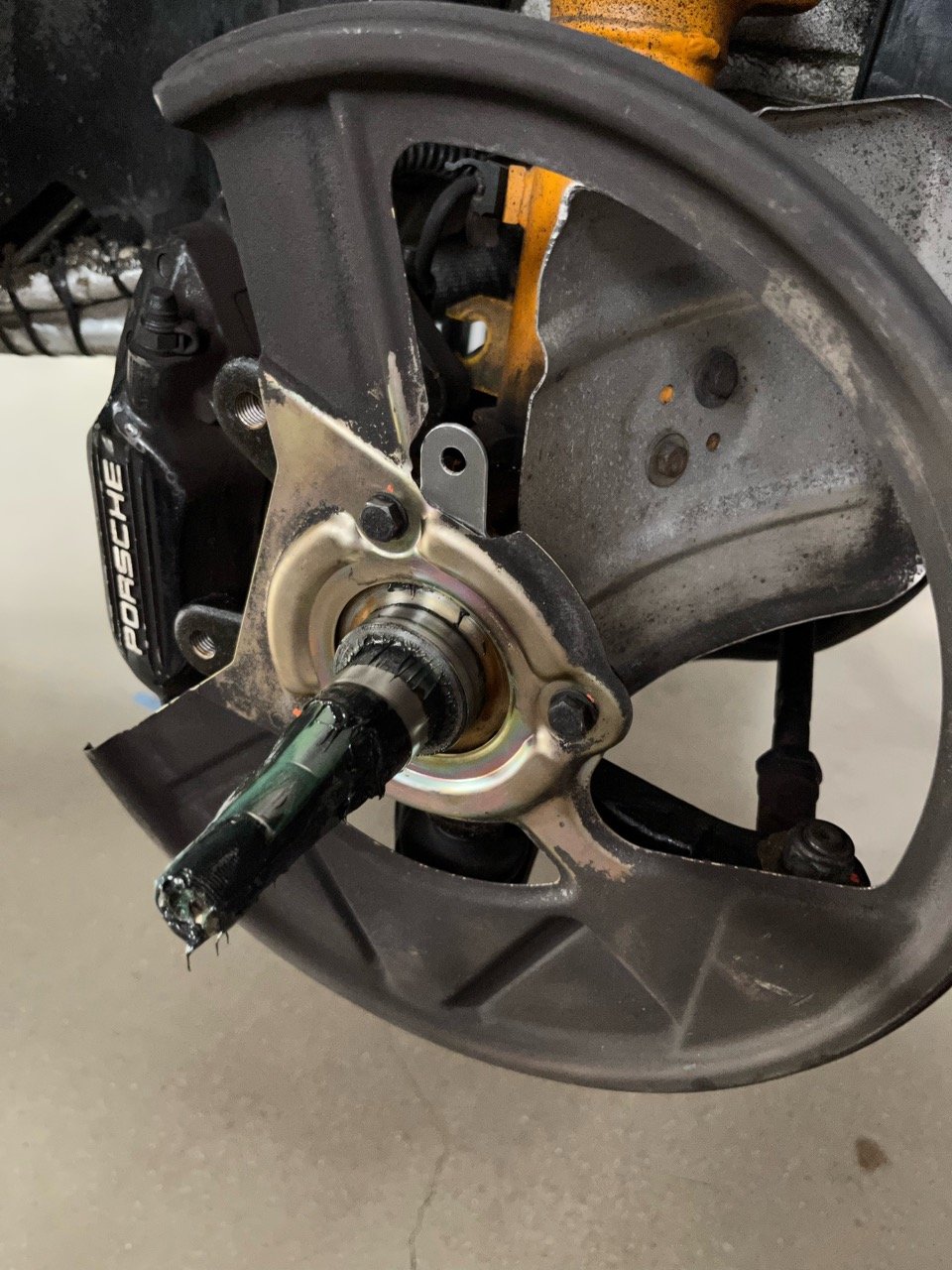

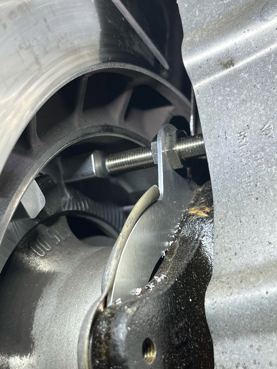

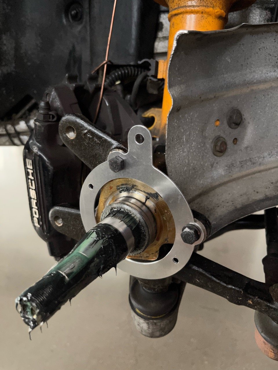

In terms of install, perhaps you can fit a tone ring to the hub and mount a speed sensor on the knuckle. Alternatively, it may be easier to fit a flat trigger disc to the hub, similar to what might be used for crank position sensing. If that wouldn't throw your wheel offset off too much, that could simplify things.
Here are some pictures of a trigger setup I did on the front of a 1986 944 Turbo.
Mike, those are good points about GPS - reminded me of why I didn't go with a GPS speedometer.
Dave, thank you for the pictures. Nice work, and it helps to see how you have done it.

Cool job there, David - could one use the disc fins' ribs instead, to simplify the installation and double the resolution? I would suppose the primary concern is the support in the ECU, if also using it for traction control, and/or ABS conflicts on tooth count front to rear?
The problem with using the brake disc fins would be modifying a consumable part (it would help to have a machined surface instead of a casting as the target), and mounting the sensor since it would not be parallel to the axle. In the past i've used brake hat bolts, but making your own precision trigger wheel has yielded the best results for me. I have no problem using 48-tooth wheels in the ECUs I typically use.
Looks neat David.
Gerry, if you're not using the signal for traction control or ABS, you could realistically go with very few teeth and get a "decent" speed reading. More teeth, more accuracy becomes important when small changes matter. The 48 tooth number David mentioned works well for ABS or traction control, as long as your electronics support it.
I am using that 10-tooth trigger for traction control on the 944, FYI. That is working acceptably well with a MoTeC M1 ECU.
