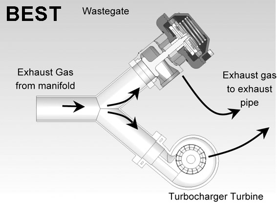

Yes that is a terrible design. You need the wastgate have the same or better flow than the turbo inlet. If you could make a new manifold, here is a diagram of the best way to do it if you have the room:
https://www.turbosmart.com/wp-content/uploads/2011/10/5529.jpeg
and this on what to avoid:
https://www.theturboforums.com/attachments/wastegateplacement-jpg.662720/
Thanks David,
Yeah I found those diagrams online as well. I knew the placement was not ideal, but I sold a couple of these before and never had any problem, although they were all in a T3 config.
My other option would be to add another wastegate at the back side of the manifold. I don’t really want to butcher this manifold, I hope that DocRace will answer me and we can find a solution together. But I will if I have to!
Well, you did the test to determine that it's the design that's the issue. Perhaps a larger wastegate pipe would help (even with the bad shape) -- it's certainly not the same cross section as the turbo port.
