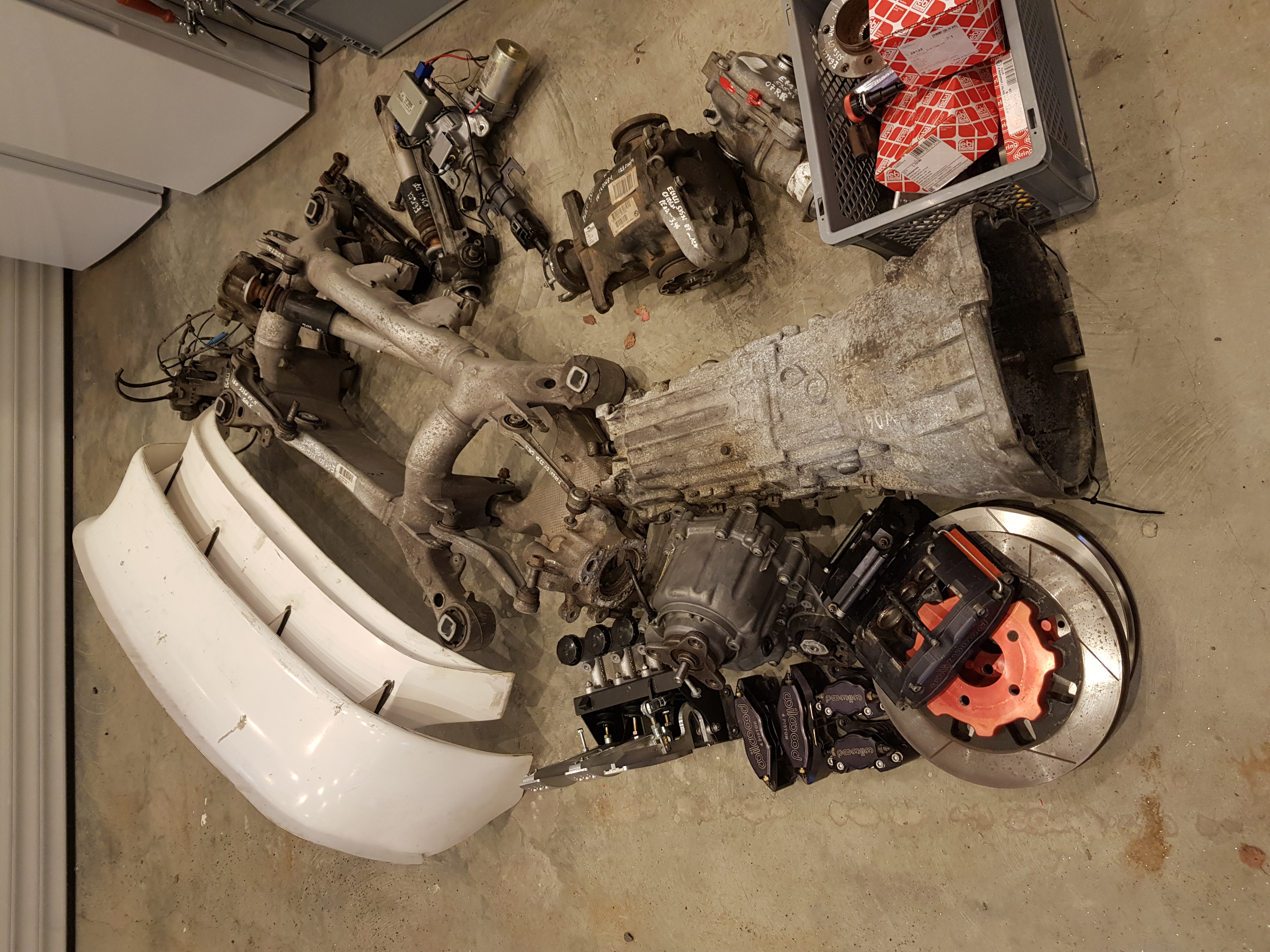

Alot of the collected parts.

This is going to be awesome man!
Impressive setup.
