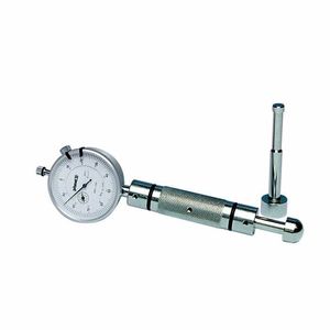

I use a degree tool similar to this one. Lifter tool Of course the only engines I have ever built are 385 series Fords and L6 Fords.
