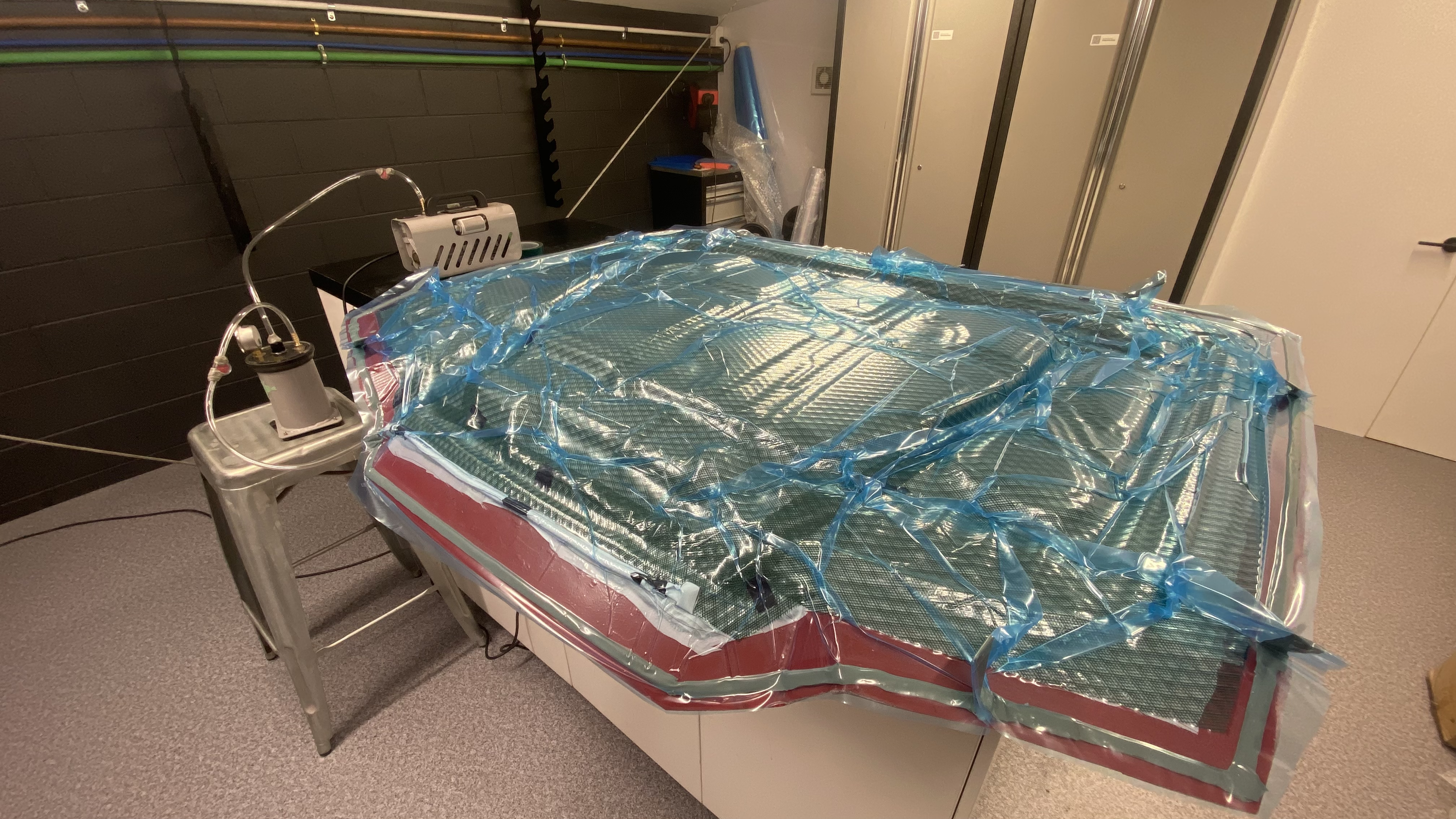

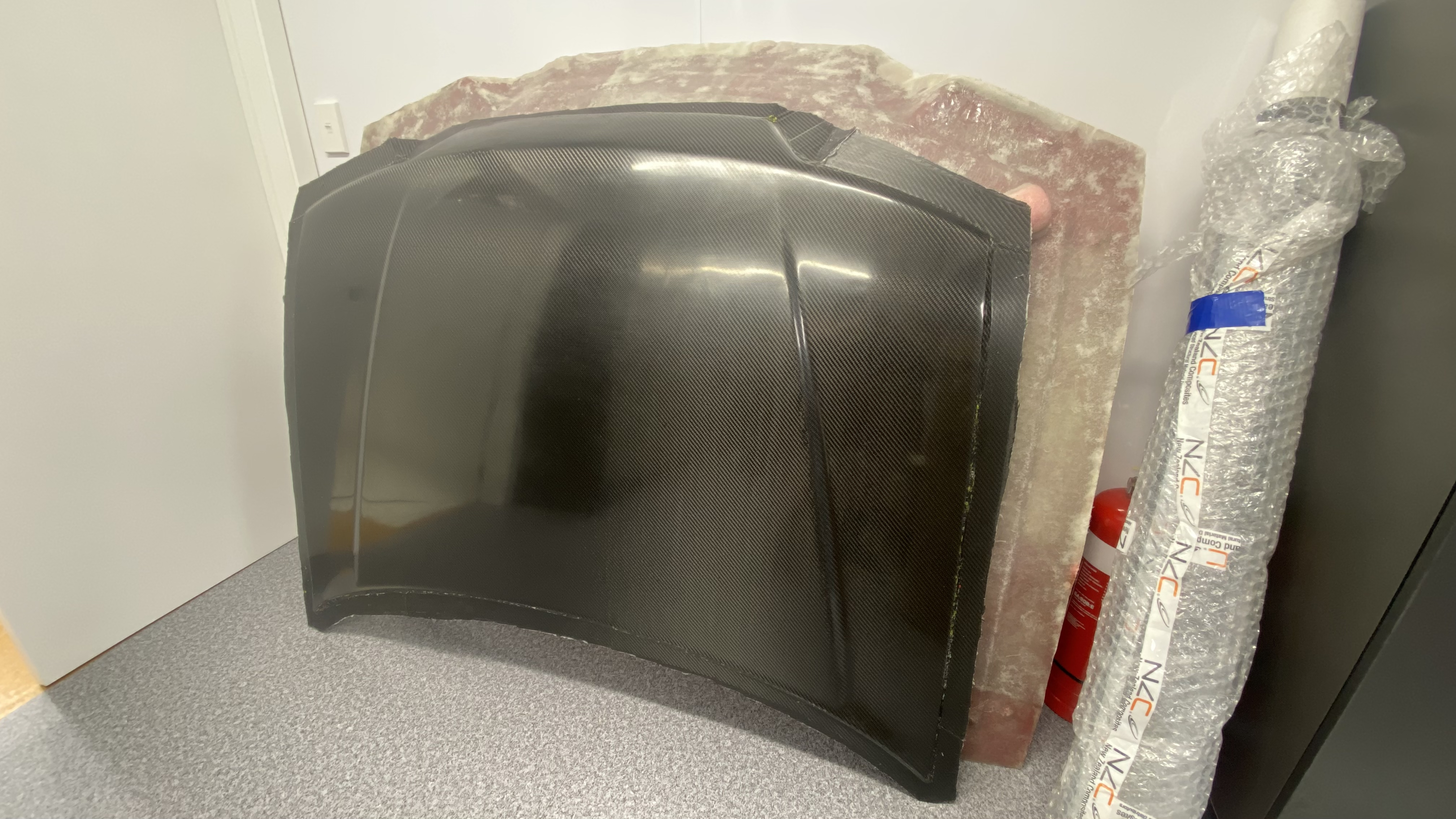

Here's an infusion i'm doing at the moment for our CRX bonnet - outer skin and inner bracing.
Infused outer skin
infusion inner brace

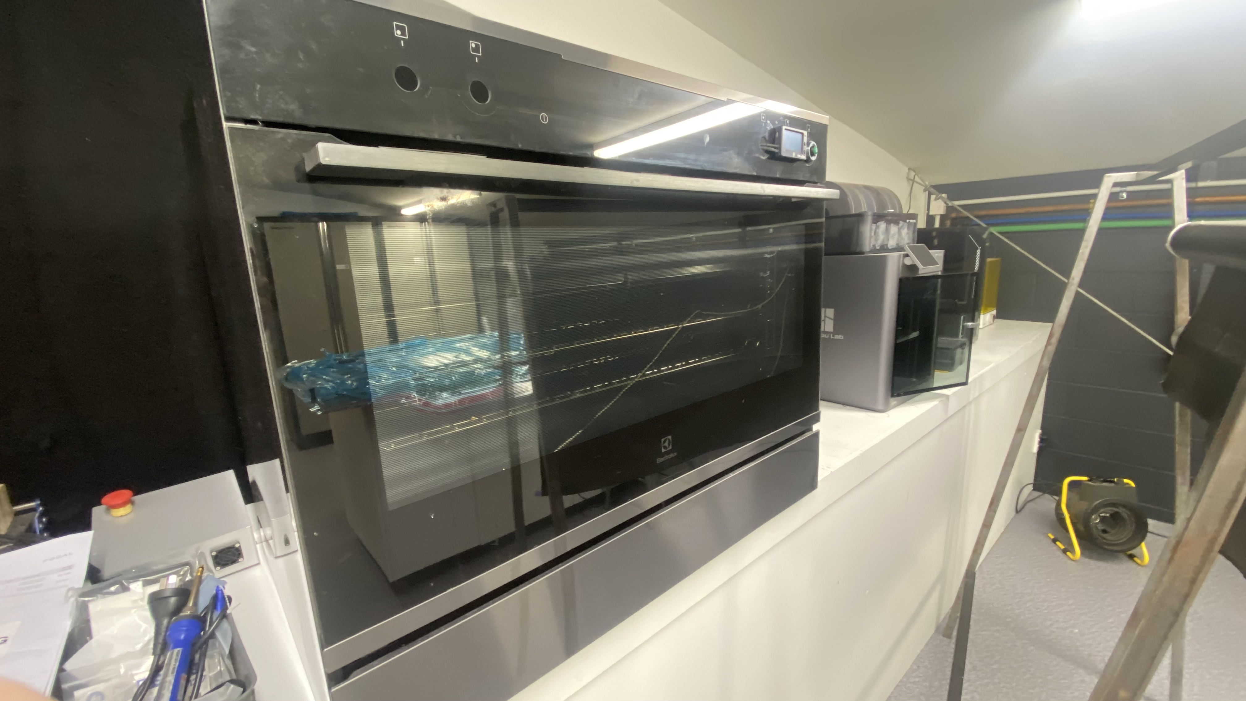

We've also just picked up this second hand oven which we're converting to PID control for curing pre-pregs.prepreg oven
