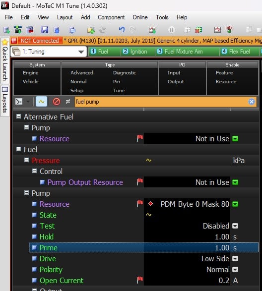

In your M130 package, configure your Fuel Pump Resource to use "PDM Byte 0 Mask 80" as shown here:
M1 Fuel Pump Setup for PDM
The Prime parameter controls how long the fuel pump with run once the Engine Run Switch (Ignition Switch) is active. The pump will automatically start when the engine is cranking.
