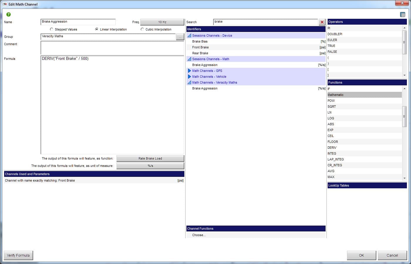

I'm struggling to convert some of the formulas from the videos over to AIM which is the primary software I use. Is there any way to get the formulas mentioned in the course converted to AIM or some sort of guide on how to do it? Some are pretty easy but others are just not working for me. I'm trying to build the brake aggression and throttle aggression channels right now and getting no luck so far.
Are you using RaceStudio 2 or RaceStudio 3?
In RS3, I use something like Brake Aggression is DERIV("Front Brake" / 500) (where 500 is the normal maximum braking pressure). I set the output unit to "Percent/Sec" -> "Rate Brake Load".
How about some more details on how you are stuck?""
