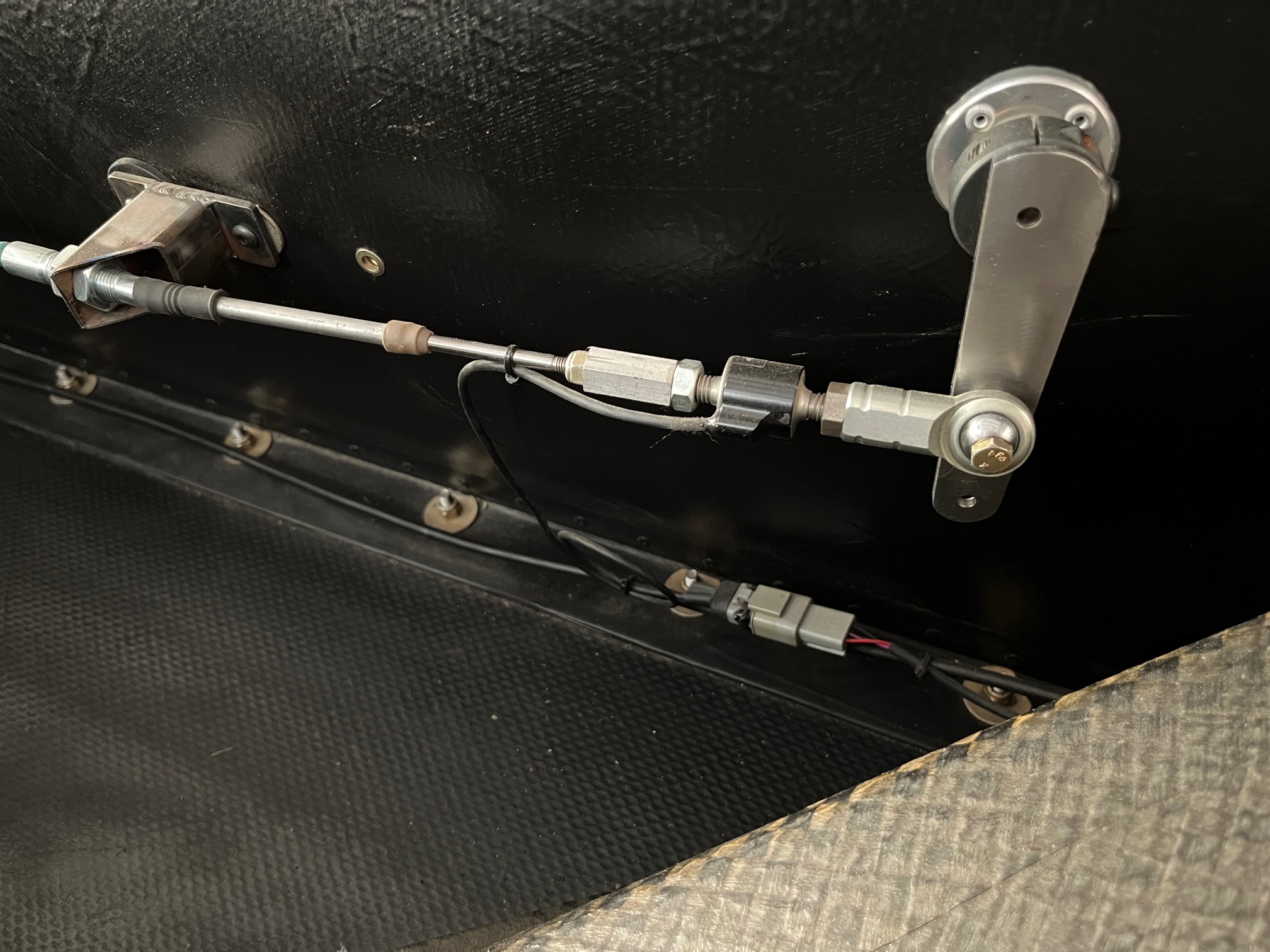

Hi again,
What is the preferred mounting method in your opinion? ie. embedded within the gear knob (angular movement) vs integrated (push / pull) or other proven techniques ?
Your help is highly appreciated.
TIA
D
"The Load Cells are generally installed into the actuator rod or cable on sequentialgearboxes."
It's a longitudinal design strain gauge.
Thank you Gord.
Here is how that sensor is installed onto the end of our shift cable.
GSS Installation
