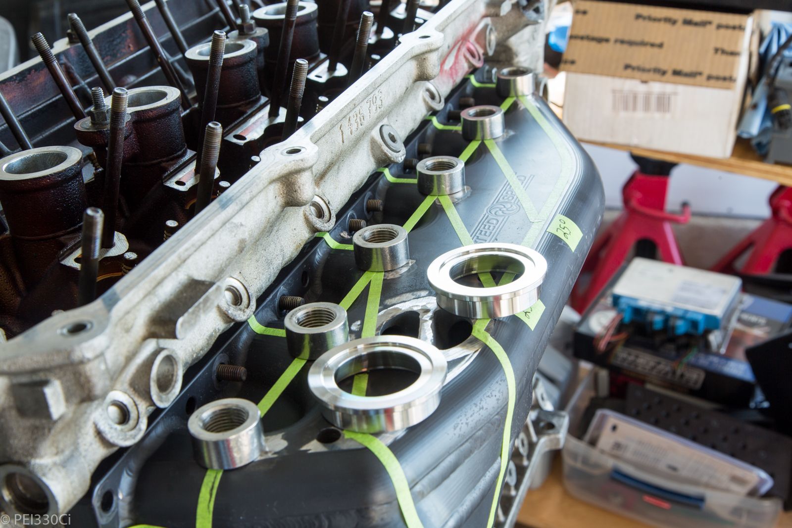

By adding the 2 WG in the positions shown, I'm now increasing the surface area exposed to direct flow by nearly 300%

On the boost control front, I've been cutting up my existing manifold to add 2 waste gates with more direct access to exhaust flow:

Also, one wastegate per scroll is a good idea, although you may need a tubular manifold to do it, rather than trying to actually tap into the turbo... It's very common on engines that boost control problems like Rx-7's. The other option is to run one big single gate and pull one big runner off of each scroll, merging into the big single.

Any thoughts on putting an MVS waste gate directly on each scroll of the turbine housing?

Also, for those that haven't picked it up yet from the photos:
Bank #1, with Cylinders 1-3, has a straight shot at 1/2 of the WG port.
Bank #2, is compromised. Cylinder #4 has a straight shot. Cylinder #5 has to make a 120 degree turn, and Cylinder #6 has no direct path to the WG port. (It merges with the flow from Cylinders 4 & 5 just before the turbine housing)
While I am concerned about the reduction in WG flow that this situation creates, boost control isn't the only variable affected. My issue with this is that you are affecting the VE of each cylinder differently, as you open the Waste gate. So rather than have a fixed VE curve for each cylinder based on manifold pressure, the engine will see less airflow through cylinder #6 than cylinder #1, and this will vary based on the difference between the boost target and manifold pressure.

One of my main questions is: Why don't OEMs attach waste gates to the outside radius of the turbine housing scroll?
Borg Warner puts the IWG at the entry to the scroll with the EFR turbos, but they have proven to be highly in-effective at managing boost if you have a very efficient turbo manifold like the one that I'm currently using. (We are seeing boost creep up to 22-23 PSI before stabilizing, making lower boost targets impossible)
Of the 7 options I've listed above, running a waste gate or 2 on the turbine housing is the most recommended by experienced fabricators. Changing the manifold would create more problems than it solves from a packaging and longevity perspective.
