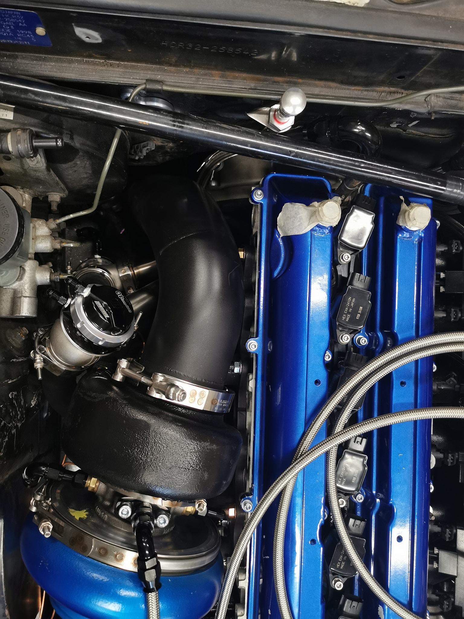

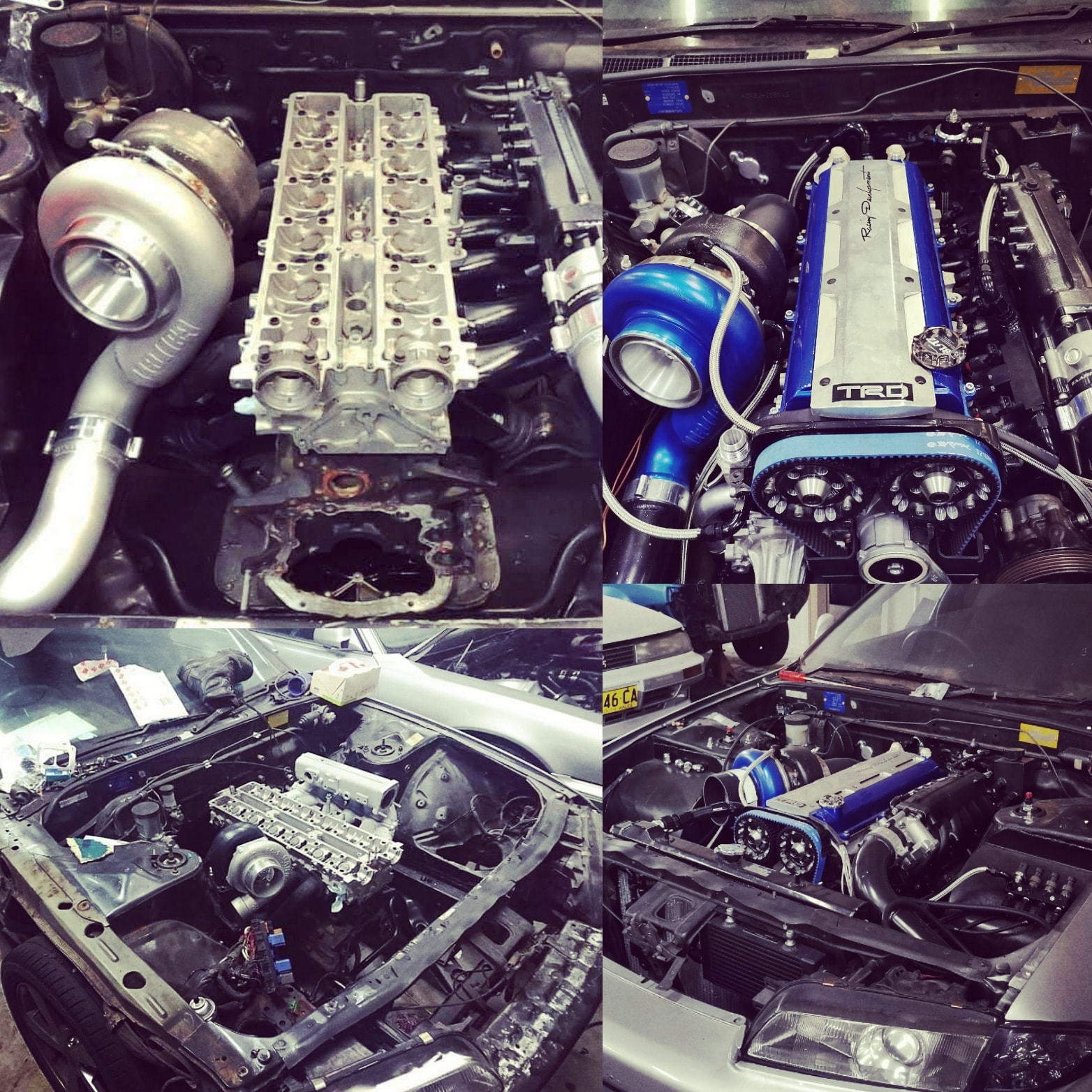

Car 1994 R32 four door with wide body kit full Gtr front end
Engine:2jzgte
:cp pistions,nitto ibeam rods, billit main caps, 264 intake and272 cams ported head oversize valves
:Turbo G42 1200 1.15 housing ,Twin 45mm turbo smart gates 6Boost manifold with 6 egt bungs
:Stock intake with Dbw Racework rail with 2400cc deka injecors
Fuel system: Turbo smart fuel reg 2000, tarrks tripple surge 3x 540 walbros 1x460 lift pump dash 10 fuel feed to dash 8 to rail with dash 8 return
Gearbox: th400 built by turbo ted with trans brake with 5000stall dominator
Electronics: Ecu kv8 emtron, pdm 30 black box , ls alternator
Sensors: 2x map 1xwater temp\presure 1x oil temp\ presure 1x fuel pressure\temp 6x egts 1x exhuast back pressure
Exhaust: 4Inch dump in to 4" system with aes muffler and resnator
