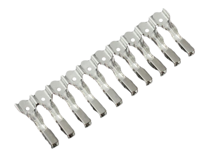

I have noted it would greatly simplify some of my jobs if I could build bus bars for things such as this fuse rail.
I see some options for some fuse boards/connectors, but they always seem to have limited wire size options.
https://i.imgur.com/qa3T2m2.png
I have attached the relay fuse carrier I would like to adapt in this case.
I guess you could tig a stip across and notch out the bottom of the holder to allow it to slide up inside; like so https://www.12voltplanet.co.uk/user/products/large/Mini-Blade-Fuse-Busbar-Terminal-Strip-2.5-4.0mm2-cable-For-MTA-Modules-1708336.jpg
Any thoughts? Any solutions out there I have missed?
