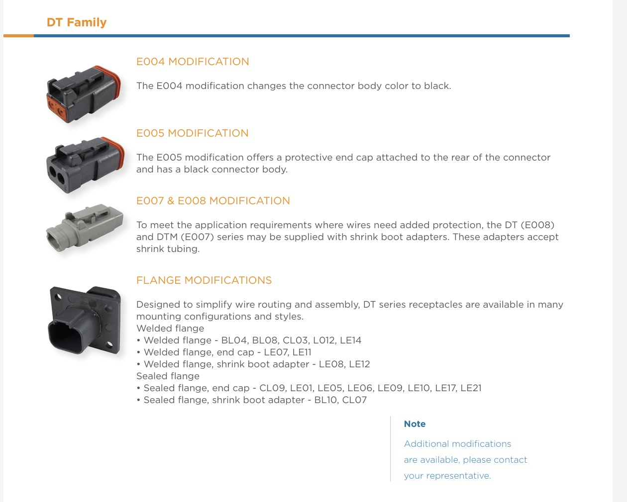

is there a specific name for the dtm connectors which uses a boot?
You should look in the TE catalog for these types of details. Here is the connector catalog featuring the DT/DTM Family:
https://www.te.com/commerce/DocumentDelivery/DDEController?Action=srchrtrv&DocNm=TS_ICT_T_C_CAT&DocType=Catalog%20Section&DocLang=English&DocFormat=pdf&PartCntxt=DTM04-08PA
Page 122 describes the E007 modification that adds the piece so you can use a boot over the back of the S connectors.
catalog snapshot
