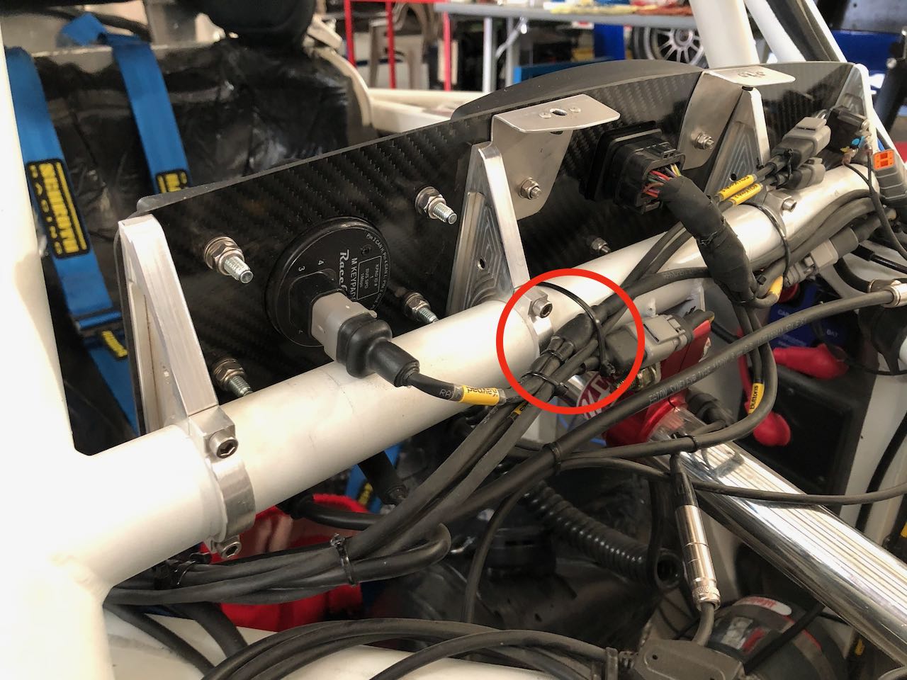

I typically just use adhesive lined heat shrink where there is a branch. For strain relieve, I will often tie the multiple branches with a wire tie right at the end of the adhesive heat shrink.
Here is an example of what that looks like (see red circled area)

It's probably different than your application, but the dimensions could be similar. Sheathing with some of the non-split options can be done even on short branches, it just takes planning and some effort.
