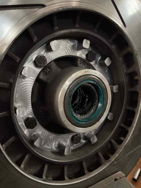

Here are some pictures of a trigger setup I machined and mounted on a Porsche 944:
How would I go about doing this as I have no access to a lathe to machine a piece like this
I have done something similar to David's method before but with the sensor just pointing at the back end of the wheel studs. Probably not suitable for traction control, but perfectly adequate for vehicle speed. A GS100502 is often a nice easy sensor to mount for this sort of thing.
