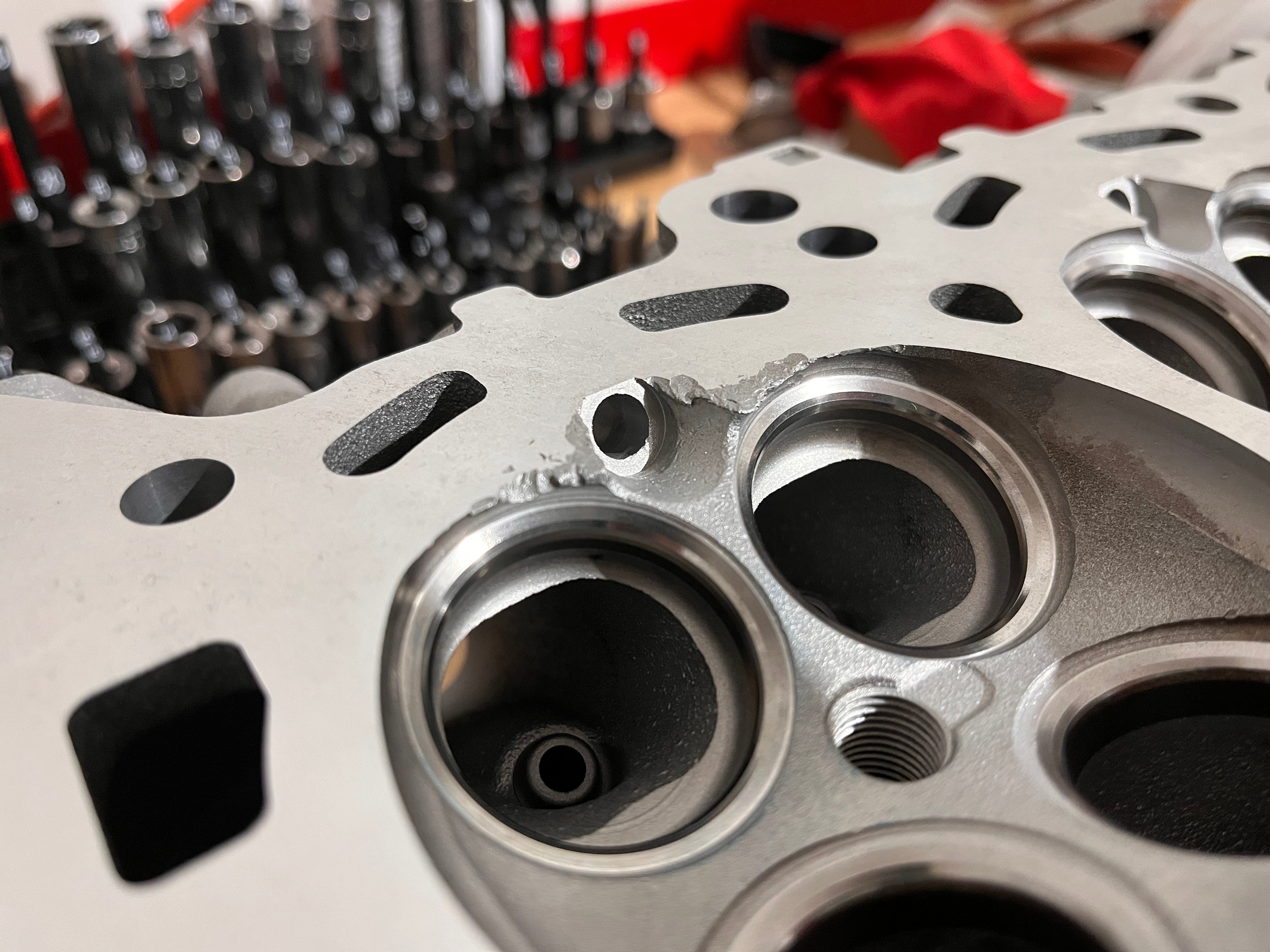

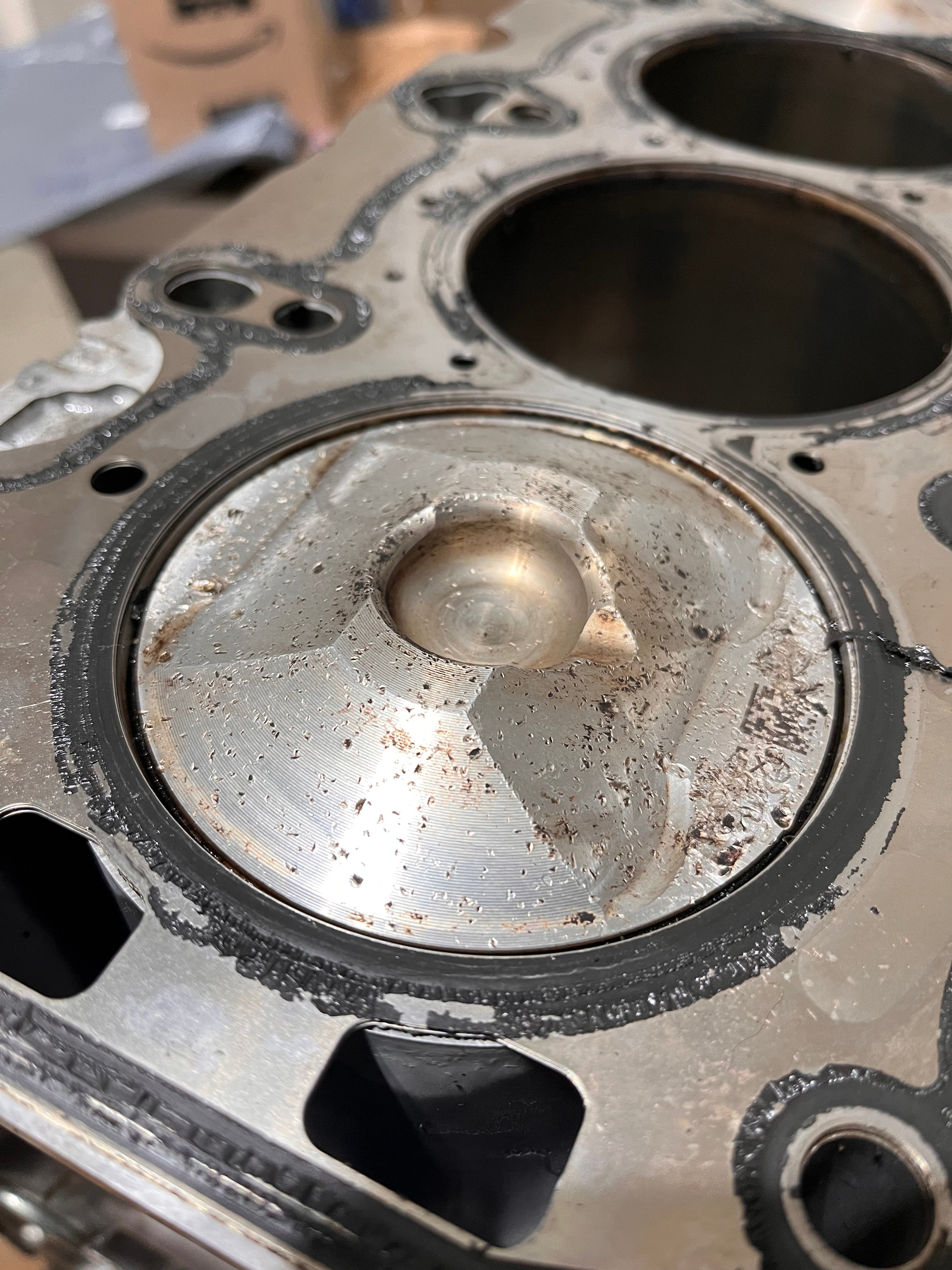

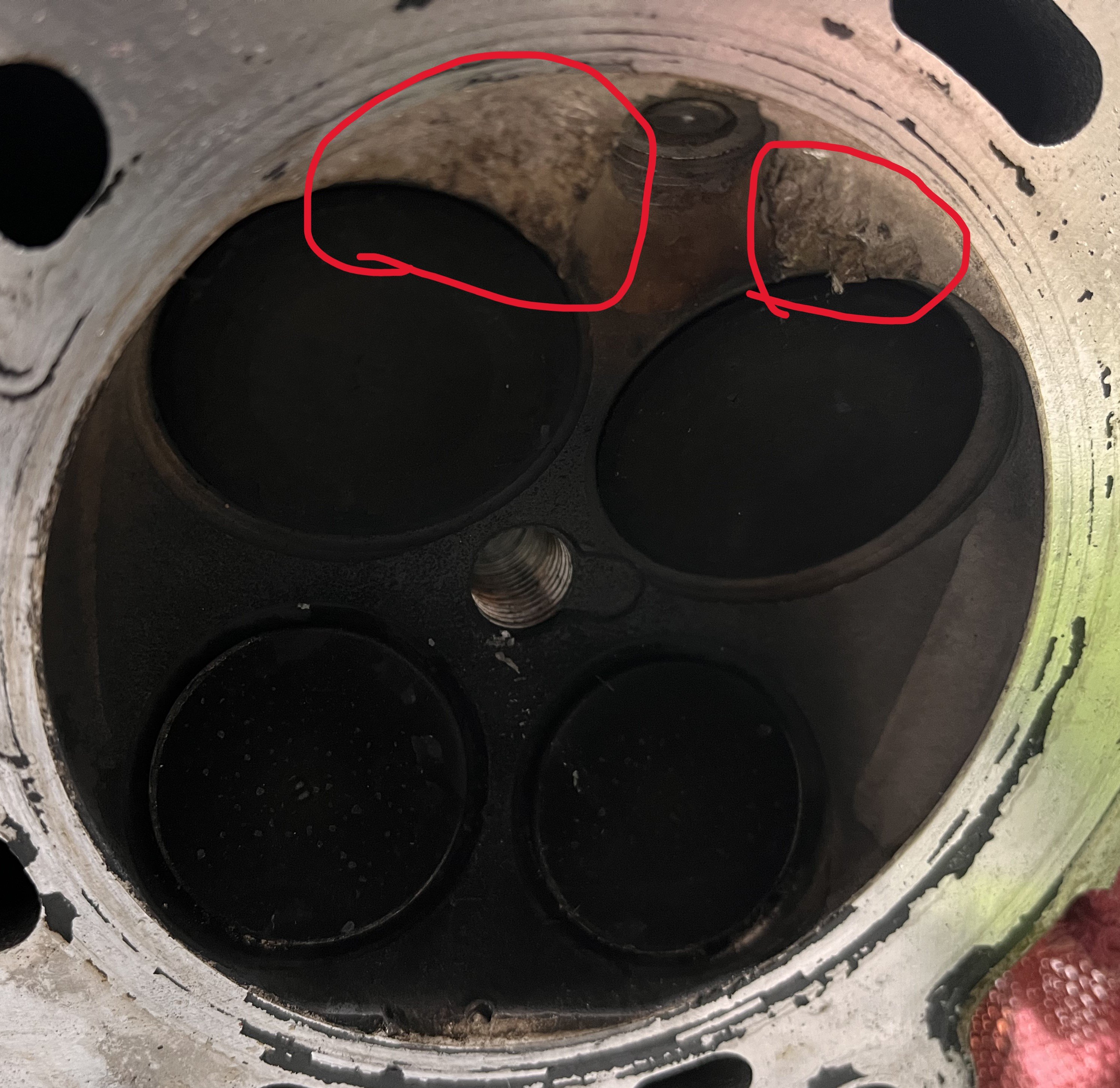

Teardown revealed "blunt force trauma" inside engine, which is likely what bent the valves, see pictures. Cylinder walls okay.
Deck had 0.008" gap between cyl 2/3 when checked with straight edge.
Machine shop found 5 slightly bent valves, decked head, faced valves and refinished valve seats.

Damage before machining
Machined head, remnants of damage
Piston damage
