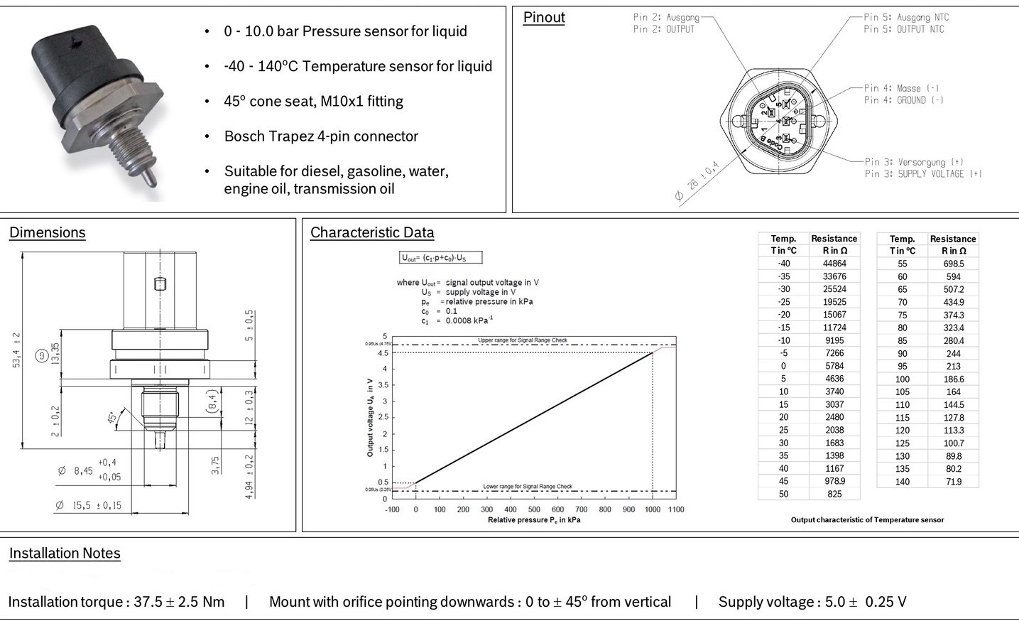

Hello,
I've been using the Bosch combination fluid temperature and pressure sensor pictured, but I've seen enough failures that I'm interested in hearing what options, if any, are working for folks.
Specifically the failure mode is fluid comes out the back of the sensor, goes into the wiring and when it's water, shorts things out.
Combination temperature and pressure is favorable from an ease of install standpoint on builds that aren't full motorsports grade, but if it turns out there simply isn't an option that's worthy, I'm also happy to be told that and stick to the separate units I generally don't have issues with.
Thank you in advance!

Hi Gord,
Thanks! It's the Bosch PST-F 1 which is a 0-10 bar fluid temp and pressure sensor.
I get them from Link Engine Management. Data Link provides:
Data from Bosch attached.
They also have a higher pressure version but it's 0-280 bar which doesn't suit my needs (oil and water pressure), then a version which costs a few thousand dollars per unit, which is too costly.
Does anyone have firsthand experience with the Honeywell option?
  • Pressure_Sensor_Combined_PST-F_1_Datasheet_51_en_23446188555.pdf

The genuine Bosch sensors part number is:
Bosch 0261230340
I've heard of people having failure on them but the fact that Porsche and many other manufacturers use them at OEM level on mass production cars I'm betting the failure rate is a tiny percentage.
As OE are using them only on oil systems I usually recommend customers only use them for oil as well

Just talked to Bosch Motorsports and here is what they said:
Excess torque when installing the sensor can break it internally and it causes the leak in the connector.
They recommend 24 nm.
And there is two PN for this sensor:
0261.230.340 and 0261.230.482
482 have technical upgrades that they didn't tell me what it is. He asked me which one failed.
482 are the ones I've been using and struggling with. They never fail right away, and that torque value is actually higher than what's being used (15 ft lbs), so I don't think that is the issue, but that's good info.
Link provided this info from Bosch a few weeks ago for the 482 part number:
"Use recommendations have changed
Combined Pressure and Temperature Sensor.
Bosch have issued new application advice for this sensor. This change is aimed at limiting damage to the sensor which can be caused by fluid cavitation. The validated fluid list for this sensor no longer includes water and/or coolant. It is still suitable for Diesel, Petrol, E85, Engine oil, and Transmission oil."
