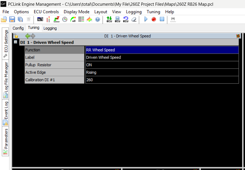

The only issue was I having is that since I had to wire it direct I was getting no feed into the ECU. Back then I didn't need it, but now I'd like to try and use some boost by gear tables. So I will need it.
Easy way at this stage is to simply splice two outputs into the speed signal output, so long as this won't disrupt a clean signal to either.
I don't reckon the ECU (Link G4+ Xtreme) would require any convertor, surely it can work from the direct analog input. I can't currently test anything, since I am still wiring the car, so I don't know if the issue was from the input to the ECU, or if the input was working fine and the output was the issue.

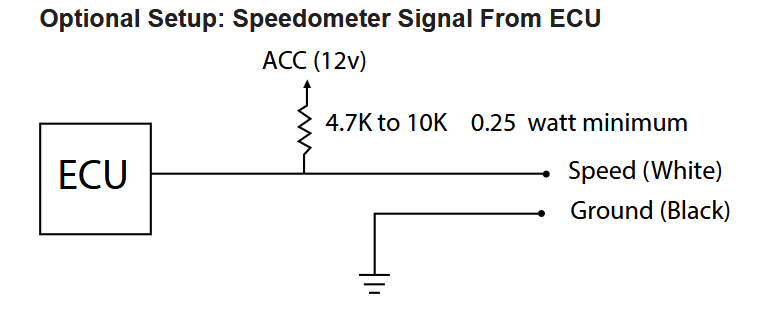

Output from ECU to speedo should have worked like this, but never did.
That diagram would assume the speed signal is an input on one set of pins and the ECU will output the speed signal on another AUX Low Side PWM capable pin. This is not sharing the speed signal, it is using the ECU to pass through and output a dedicated signal to the gauge.
Some ECUs are capable of this and some are not. To do this correctly, the ECU will need the ability to send out a variable frequency across a fixed duty cycle. This is not common for normal engine related outputs. For example, a boost control solenoid will work on a fixed frequency and a varying duty cycle. Typically the output will have a single value for frequency and the control tables will determine the duty cycle.
Understanding a little better what you had previously tried, You might want to flip the splice direction around. Add an external pullup from the sensor to 12V, as shown in the diagram. Then wire this signal to the ECU and speedometer. This way both devices will receive the signal.

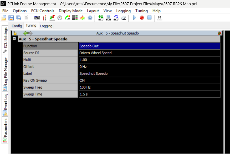

Best would be to connect the ECU plug, then get the output (Aux 5) to work correctly with the Speedo. The question about splicing is a backup solution if the output is not suitable to make the speedo work.

There should be no reason the ECU cant drive that speedo from an aux output. No pull-up resistor is needed as the ECU has a 12V pull-up internally.
Thanks, I shall just be patient ans wait until its up and running again, then try and get the input sorted, then the output should be easy also. And to clarify, you are saying that the external resistor is not required as I can set a pull up resistor for the AUX output in the software? How about the +12V spliced in?

@EF Ian, the Speedo wants to see a High Side Square wave signal. If one is not available, you will use a Low Side output with the 12v/pullup. If a High Side output is available from the ECU. You will just wire that output directly to the Speedo input.

Looks like my older version of the G4+ does not support high side outouts. So I will require the external pullup.
"Since your Red and Black G4+ Xtreme only supports Low Side (ground switching) on Aux 5, you cannot directly send a 12V pulse to your speedometer. However, you can achieve this by using an external pullup resistor"
I will set it up and bench test it. I believe I can do this by changing fuction to 'test PWM'

You dont need the 12V or the external pull-up, there is already a pull-up internally on Aux 1-8, you dont need to "turn it on" in the software, it is always present.

All of this is incorrect. To start with you dont need a highside drive at all, the ecu has an internal 1.5K pull-up to 12V on Aux 1-8. Connect the aux output directly to the speedo input with nothing else required. Aux 5-8 in the Red Xtreme in fact do have high side drives exactly the same as the black Xtreme, but in both cases they are only available for specific functions and it is not required for a solidstate speedo.
You would actually be better to use Aux 1-4 rather than aux 5 as 1-4 can do 4000Hz max whereas Aux 5 has a max of 300Hz. Although 300Hz would be enough for most speedos, the extra range of Aux 1-4 may be useful.

That could be why it didn't appear to function the last time it was tried, as both of these were wired in. This makes the wiring much more simple.

Good info, currently I can not do this, since Aux = Solenoid, Aux 2 = Fan, Aux 3 = Fuel pump, Aux 4 = Tacho. However since with my rewiring of the entire car, I'm moving to a PDM and most inputs to this will be via CANbus, that should free up both Aux 3 and Aux 2. So so long as I can get the setup working like I want I shall also plan to move the Speedo over to Aux 3.
