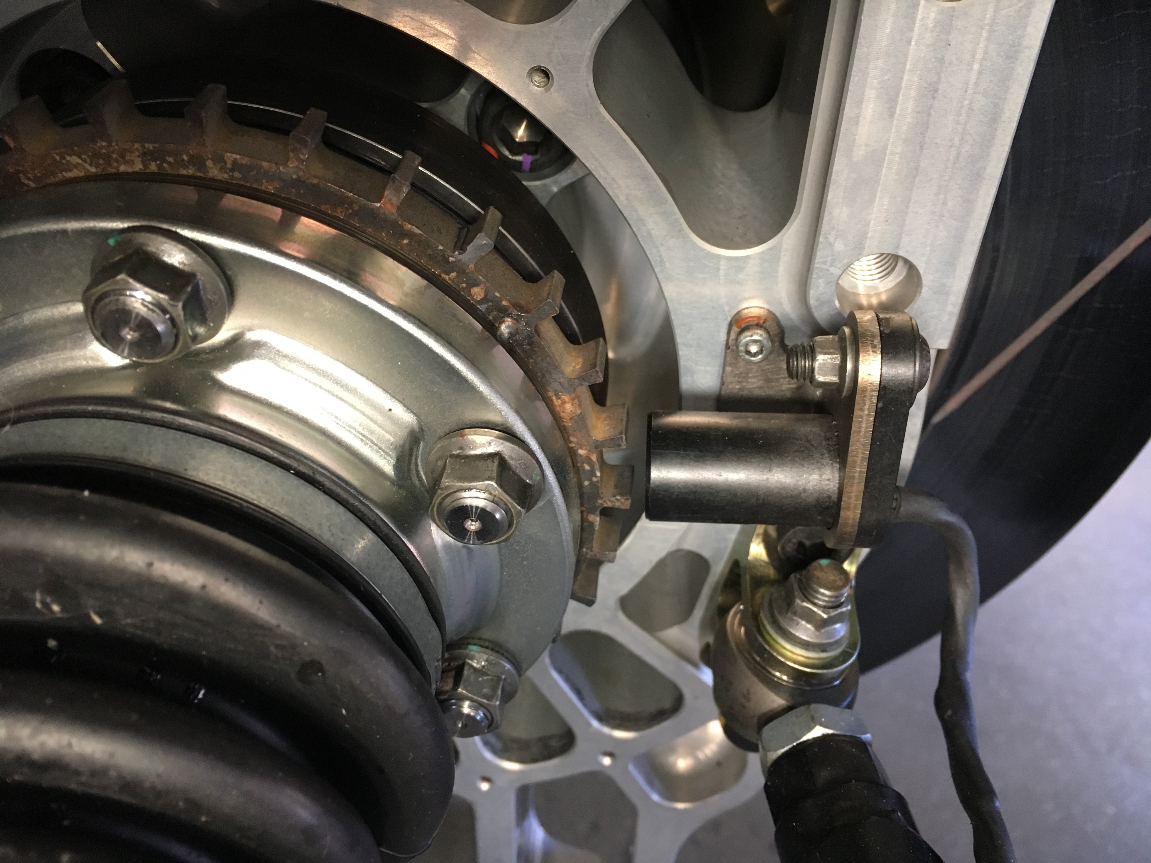

Here is a wheelspeed sensor mounted to the output flange of the sequential gearbox:
