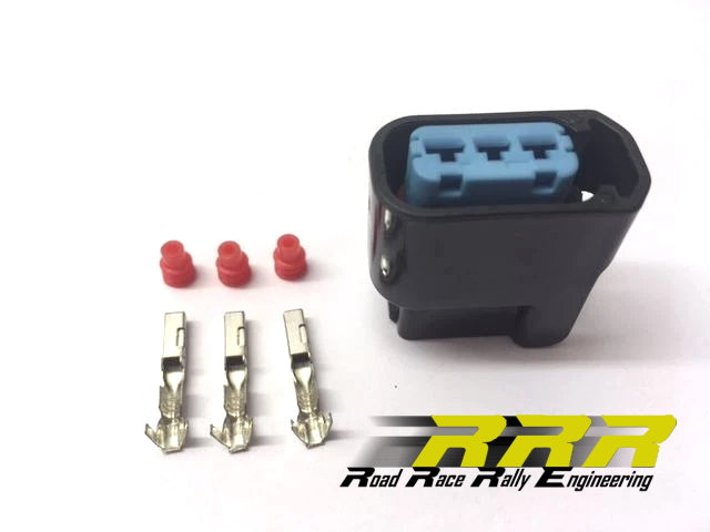

Hi - would it be possible to identify what these pins are called?
[url=https://rrrshop.co.uk/cdn/shop/products/k20coilcon2_640x480.jpg?v=1608500984]https://rrrshop.co.uk/cdn/shop/products/k20coilcon2_640x480.jpg?v=1608500984
I need a suitable pin for awg18 and awg22 wire
Thanks in advance!
Rob
Based on this page:
https://www.bmotorsports.com/shop/product_info.php/products_id/2254?osCsid=cs8fvgpi550qi85kog6m5ulsd3
I would say they are a "Sumitomo HX / DL / SL Sealed Series Female terminal"
